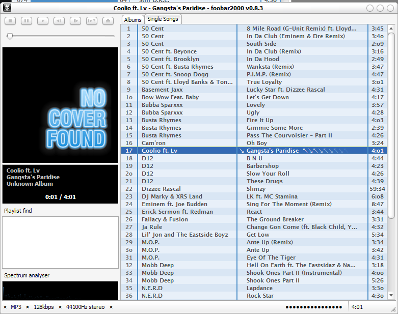

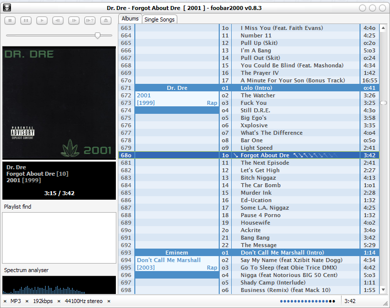

little update to mine:
albums:
single songs (and all other playlists):
