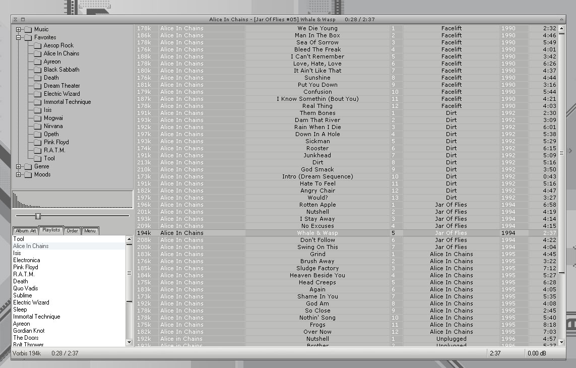

The vertical lines are just 1 pixel columns with a black background.
For the horizontal lines, put this in the "colour" tab for every column that has text in it.
$rgb(0,0,0)|
$rgb(255,255,255)|
$rgb(255,255,255)|
$rgb(75,100,125)|
$rgb(75,100,125)|
$if($stricmp(%tracknumber%,'1'),$rgb(0,0,0),$rgb(255,255,255))|
The single "|" in the second last line is needed.
The last line draws the horizontal lines.
Awsome, thanks for the tip. One last question.
//[%artist%]
$if($stricmp(%tracknumber%,'1'), %artist%)
$if($stricmp(%tracknumber%,'2'), %album%)
$if($stricmp(%tracknumber%,'2'), - %date%)
That's my artist column. On track two, it'll say, for example:
Jar OF Flies - 1994
I'm trying to make it so Jar OF Flies (Album name) is in white, and 1994 (date) is in black. How might I do this?
