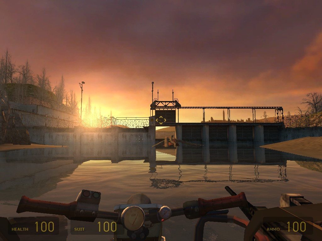

There IS a 30% boost in performance. What you guys dont understand is that when I force the game to run in dx9 with the command mat_dxlevel 90 I get messed up graphics and even worse fps than 8.1, around 5-30. BUT, when I did this it looked so beautiful. Water reflects eveything, depth refraction and even soft water to land effects and normal mapping and all the dx9 goodies and its about 45% faster than dx9 when I tell hl2 I have my 5900 ultra and run in dx9 with that command (mat_dxlevel 90). This is a great way to improve DX90 performance AND graphics OVER forced DX9. Now I get about 30fps to higher than refesh rate (140fps). This is sick, gotta try cs source now.
Hl2 graphics settings:
1024x768
EVERY option high except tecture filtering at trilinear.
Reflect ALL
Asus P4P800-Deluxe
Intel 2.6C P4 @ 3.3ghz
1 GB (2x512mb) Dual Channel DDR 3200 Kingston
Gainward Geforce FX 5900 Ultra @ 592/932 mhz
Creative Audigy 2
Why don't you take a screenshot for us and post it.  And while your at it type in 'cl_showfps 2' in the console.

Ok, I took a screen at 1024x768 everything in the options menu high except filtering is trilinear. Water reflection says I should run at reflect world but its on all instead. This is the lowest I could get the fps to get, even 9800 XT and 6800 and x800 have strange fps drops when you get close to models of high detail, I also looked at it while looking back at the world so its also seen in the reflection. I did the cl_showfps 2 but minimum fps is 0 right when the maps load so its a useless number, it plays 30-146 but sometimes gets that stutter that other people on the steam forums have complained about on any card that runs in dx9, it lasts for about 3 o 5 seconds then goes away and comes back only when you enter a new area and then you get the stutter again for 3-5 seconds. 30 fps is when I am shooting a bunch and there are like 6 antilions jumping at me and there is water. 146 fps is when ther is no water and I am not really close to a model (model takes more than 80% of screen) or i zoom in on a model. As you can see, great reflection, normal mapping on models, the water/land transition effect, cool beans, better than typing mat_dxlevel 90 in console and getting corruption and even lower fps.
BTW, I did this for cs source and it did ok but still no world reflections, but I do get the better shading, normal mapping on models, but no water improvements, water still looks like 8.1, just refractive and fake ass reflection. I went back to 8.1 for cs source cause id rather have the 200 fps in 8.1 than 40-80 in dx9 because online you need really high framerates all the time.
