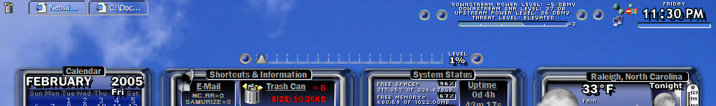

hey, this is what it does: http://www.ag1.de/utils/index.html
see in the picture? that's what you wanted.
i read through the readme and it looks like you should do this:
1. set a = some number between 0 and 255. 0 = no transparency (i.e. opaque), and 255 = 100% transparency. since you want the taskbar items (icons, buttons, etc.) to be opaque, set it to 0.
2. set c = the hex value of a color. this is the color key, which means the elements with this color will be hidden (not drawn). so pick a color, obviously one that isn't used very often (the author gives a suggestion) and set c to that hex value.
now, in your vs, reshack the taskbarbackground bitmap and make it that color, so taskbar transparent will make that color hidden, i.e. completely gone.
3. set s = some number between 0 and 255. this controls start menu transparency.
run the app to set the values, and you're done. remember, it won't run in memory, so now resource usage. :)

Can't seem to et it to work.
I Reshack the TaskbarBackgroundBottom to a red bitmap. Ran the exe with a=0 c=FF0000. And the whole taskbar went transparent, no icons no text. Whats going on?
https://www.neowin.net/forum/topic/251243-clear-taskbar/#findComment-585479556
I finally got it to work too... the secret for me was not to use "$" or"#"
example: c=FF0000 and NOT c=$FF0000 or c=#FF0000

:cool: Look what I started! LoL ....... You need to match the color you are gonna use to your wallpaper so the icon or text outline doesn't show up like in your pic...i made mine a similiar blue so it doesn't stand out against my sky wallpaper.
I also took everything out for a total transparent look...even the tray is transparent and I ditched the start button!!!!!!!
