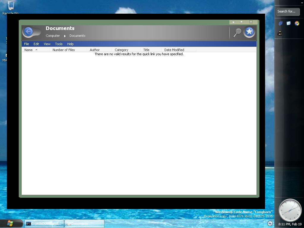

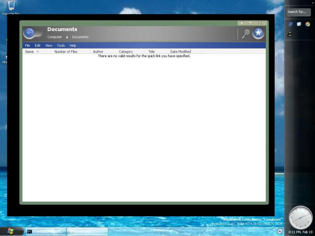

there is an easy way to make it so that aero glass will work without dwm. it involves hacking a file though :p and finding the file is still a daunting task :)
but once thats done, you can run glass side/taskbars without turning on dwm :)
an example
(geez, i posted that pic in two threads already... >_<)

http://www.aeroxp.net/board//index.php?showtopic=103
Some people in other boards (like this one ) wished they could be able to run the aero glass taskbar and the semi-transparent sidebar without the "bugginess" of having the DWM enabled.
If you dare hack a single DLL and exchange a couple characters (to keep CRC check from getting aware of the hack) then you can have the usual Jade theme working perfectly without needing to enable DWM nor needing to keep changing the registry one and other time just to keep that.
You'll need a good hex editor.
Here you go:
Start your hex editor and, with explorer, go to
WINDOWS\assembly\gac_32\System.Windows.Explorer\6.0.3708.0__a29c01bbd4e39ac5
Copy System.Windows.Explorer.dll now into System.Windows.Explorer.dll.bin
and stop Explorer.exe from task manager.
edit System.Windows.Explorer.dll.bin
With the hex editor, search for this string:
4d0049004c004500 (it's the equivalent of MILE in Unicode)
and replace it with:
49004d004c004500 (the equivalent of LIME) hence no CRC damage
Now rename System.Windows.Explorer.dll into System.Windows.Explorer.dll.bak
and rename System.Windows.Explorer.dll.bin into System.Windows.Explorer.dll
Start regedit from Task Manager and change the old DWORD value of MILExplorer into LIMExplorer
Restart explorer.exe from task manager.
Since the explorer windows are made out of code inside other libraries that don't pertain to the avalon interface, they will open as usual because there is no longer an MILexplorer entry telling them to expect DWM, and since the Avalon assembly-driven traskbar and sidebar run from the DLL we just changed, then the glass effect will appear in those two areas of your desktop. Result? your beloved glass without DWM bugs and no unneeded hassle!
Maybe Stan would like to integrate the procedure into a single, small EXE wink.gif
