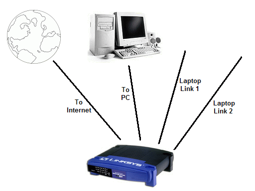

There is an attached image to accompy this post to help understand.
I currently have a 1536/256 cable connection coming into my bedroom which plugged in to a router (Linksys Etherfast Cable/DSL Router with 4port 10/100 Switch). My PC is connected to the router, and there are two links going downstairs for the laptop (can simply plug into either one). This all means the PC and laptop can use the Internet connection at any time.
However, I want to remove the router out of the equation. It's causing me slow speeds and I'm sure it's to blame for my constant 'speed hack' problems in UT2004. I have unblocked (or whatever it's called) all ports etc. and I don't want further advice on how to configure it. I basically and simple want it out of the eqaution.
How I can have a direct link to the Internet on my PC but so that my laptop can share the connection too? Maybe move the router or something? I can three LAN points in my PC if that helps? I don't mind if the PC would need to be on for the other points to be able to be use the Internet.

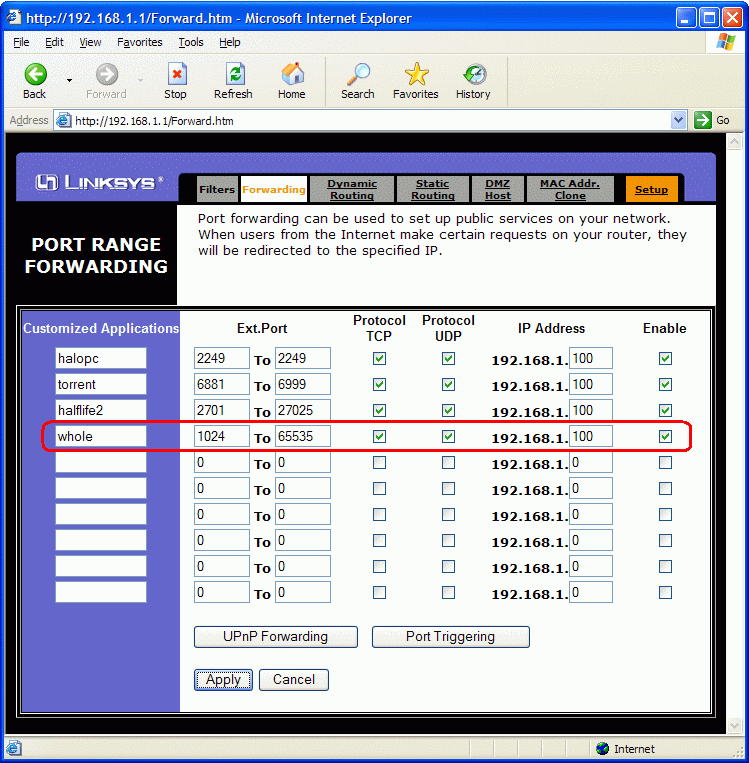

I could never host a game of UT2004 or Duke3D etc. because my IP was a static one (I believe it's called). Something similar to 192.x.x.0.0, I dunno. I even went onto www.whatismyip.com and got my IP but my friend still couldn't connect to any game. He said my server showed in the in-game server browsers (if the game featured one) but could never connect. I unplugged the Internet from the router and connected it straight to my PC. It then worked perfect. I got advice from a few people (and I'm sure I made a Neowin thread about it) and was told it was something about port forwarding. Problem was, everytime I wanted to host a server in a game, I had to find out it's port and enable it (or forward it, don't know the expression) which was annoying so I was told to open them all by opening/forwarding ports 1024 to 65535 (check the screenshot, ignore the first three entries, just couldn't be bothered to delete them).
I have disabled that service on the laptop too, as I don't know how to do it on the router. And to answer your original question, the laptop is rarely plugged in and in use. My dad and sister only check their mail etc.
EDIT: I know how to upgrade the firmware by file, saw it in the router options. No idea how to find out which one I currently have though. It's about a year or two old.
Dude - that has got to be one of the STUPIDEST things I have ever seen, remove that ENTRY!! There is NO point of running a router if your going to do that ;) And sure as hell is causing your router extra work, etc.. If you want your machine to be FULLY exposed to the public net - then put in the DMZ, you do not forward 1024-* What idiot told you to do that?
edit: If I am not mistaken Unreal uses UDP ports 7777-7780, you only need to forward those ports and ONLY UDP to your machines private IP address, ie the 192.168.1.100 to host a game, etc.. That is your machines IP address?? If not - then no it will not work, etc..
edit2: you might also need TCP 27900 and 27902? Not 100% on that.
Edited by BudMan

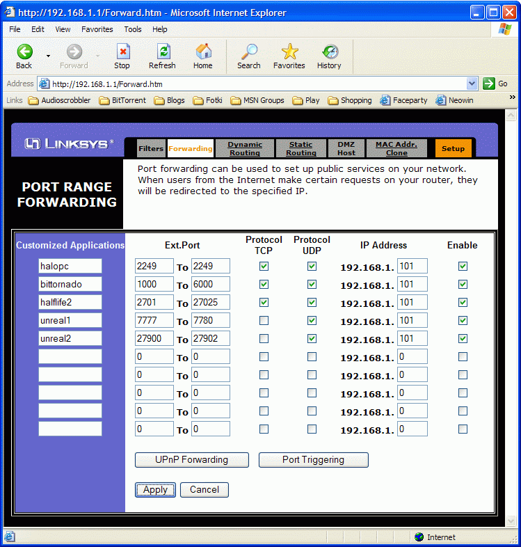

What is DMZ? And also, are these settings now correct...? It's gonna be bloody annoying having to do this with every game I want to host a server in lol

edit: I just noticed your screeny, where did you see anything about TCP on the 7777-7780 forward? I know for a FACT I said UDP! Why do you have them both forwarded?
edit2: I just noticed your forwarding the BT ports already -- 192.168.1.100 the IP address of your machine? IF not - then NO it will not work! do an ipconfig on your machine -- what does it says its IP address is?

IPConfig says my IP address is 192.168.1.101 so I changed all my 100s to 101s. I have also removed the Protocol TCP setting from the Unreal1/2 entries. Is this correct?
