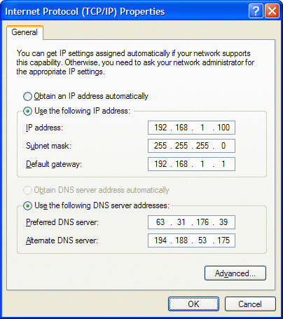

Get your machine up and running again - behind the router, which dchp.. Then look on your router's interface, what is the range of IP's your dhcp server will hand out? 192.168.1.x-x
then set your machine to a STATIC address outside of this, then forward the ports you need to your machines IP, or put your machine into the DMZ... How hard is that exactly? For example
IP 192.168.1.222
netmask 255.255.255.0
gateway 192.168.1.1 <--- this is the IP address of your router
DNS 192.168.1.1 <--- Normally this will work, or use your ISP's dns directly, or you could use 4.2.2.2, .3 etc...

I am trying to enable DMZ (if that's what I need to do to open all ports). I did this and I can't connect to the Internet...
(oh, and DMZ is set to 192.168.1.100).
