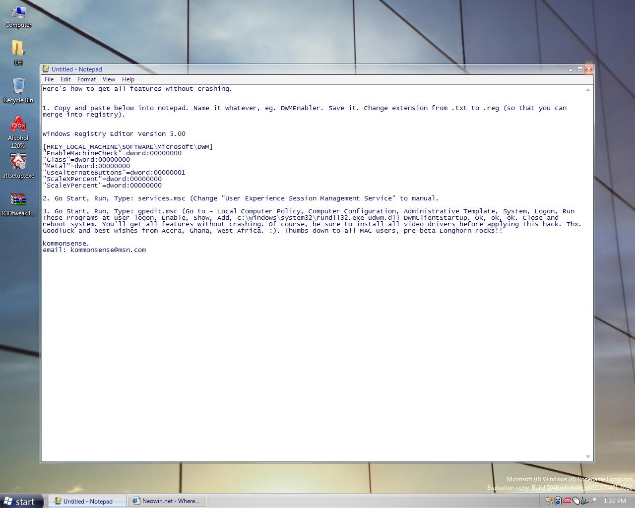

Here's how to get all features without crashing.
1. Copy and paste below into notepad. Name it whatever, eg. DWMEnabler. Save it. Change extension from .txt to .reg (so that you can merge into registry).
Windows Registry Editor Version 5.00
[HKEY_LOCAL_MACHINE\SOFTWARE\Microsoft\DWM]
"EnableMachineCheck"=dword:00000000
"Glass"=dword:00000000
"Metal"=dword:00000000
"UseAlternateButtons"=dword:00000001
"ScaleXPercent"=dword:00000000
"ScaleYPercent"=dword:00000000
2. Go Start, Run, Type: services.msc (Change "User Experience Session Management Service" to manual.
3. Go Start, Run, Type: gpedit.msc (Go to - Local Computer Policy, Computer Configuration, Administrative Template, System, Logon, Run These Programs at user logon, Enable, Show, Add, c:\windows\system32\rundll32.exe udwm.dll DwmClientStartup. Ok, ok, ok. Close and reboot system. You'll get all features without crashing. Of course, be sure to install all video drivers before applying this hack. Thx. Goodluck and best wishes from Accra, Ghana, West Africa. :). Thumbs down to all MAC users, pre-beta Longhorn rocks!! Peace out.post-30870-1114710253_thumb.jpg

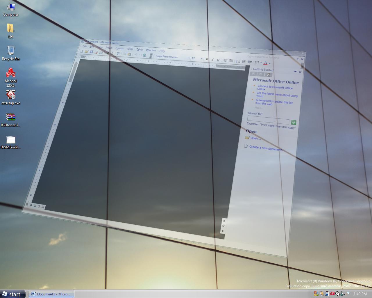

has anyone gotten the effects successfully working in vmware 5? :(
EDIT: nevermind, it works. but stuff like the bending weird transparent windows dont work (i assume they are for minimize and maximize/close animations)
