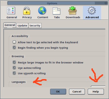

Am I the only one that finds this to be slower and worse than 1.0.6? The two extensions I use (Adblock and Filterset.G updater) work fine under 1.5b1 with no upgrading.
The new options panel is messed up for me though:
586499615[/snapback]
Thanks. They'd better sort that out or i'm staying with 1.0.6. No way am I using luna just far firefox.
586499631[/snapback]
The bug on this was reported many months ago, and people requested blocking, yet it was denied... I don't see this bug getting fixed for 1.5 Final.
I don't use luna either, but for me, only the bottom part of the "Privacy" pane is cut off, the whole prefwindow is more or less OK.
