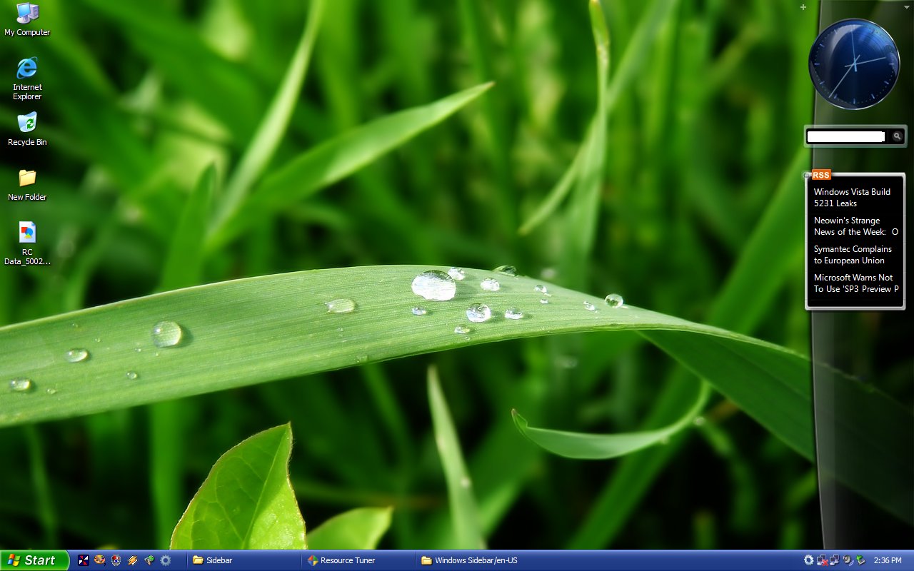

thanks whenever i made one with the fx i got an error. Just a comment on the white outline, it looks lighter in the real curved one. You can tell here.
*EDIT* and the shadow is longer
BTW, for those who want to know in general (XP and Vista users) how to change the search engine for the Internet Search gadget, looks in %userprofile%\parts\settings.ini (hidden) for this
SearchQuery=http://search.msn.com/results.aspx?q=$w
Change it to
SearchQuery=http://www.google.com/search?q=$w
for google search.

heh, you have a point there :) but I guess this sidebar will appear in an easier to install package for others who can't get through all the stages, soon enough :) - I'd bet a bacon roll on that !
Because this is the real deal, the sidebar you see here is from vista it's self, and isn't full of crap like most of the sidebars available. Looks hell lot better too and when the final product is released it will have alot more customization than any other sidebar you've seen. :)

Regarding your clock picture question, it's just a mistake by Microsoft. If you open the .part with compression software, you'll see the thumbnail is slightly incorrect for the clock. Oh well, if it really bothers you, fix it.
Regarding your Slideshow question...
This is the code in Part.js responsible for setting the folder in which pictures are loaded:
// Setting: Folder to display.
this.slideFolder = Settings.GetValue("Folder");
if (this.slideFolder == "")
	// Default: Pictures
	var ssfMYPICTURES = 39; // ShellSpecialFolderConstants for My Pictures folder
	var myPicturesFolder = shell.NameSpace(ssfMYPICTURES);
	this.slideFolder = myPicturesFolder.Self.Path;
	Settings.PutValue("Folder", this.slideFolder);
A quick, sloppy fix would be to replace:
... with (replacing the path):
this.slideFolder = "C:\TEMP";
A better fix would be to implement the settings pane for this part.
586647453[/snapback]
There's an easier way. First make sure you set explorer to view hidden files plus system files. Then navigate to C:\Documents and Settings\<username>\Parts. Here you will find Settings.ini file, open it. Inside you can change the folder for slideshow. You can also change the search engine used and the source of the rss feed.
When you're done, save it as Settings2.ini. Delete the original one then rename Settings2.ini to Settings.ini. Make sure you're doing this while the sidebar is not running :)
Forgive me if this guide is already been posted before.
