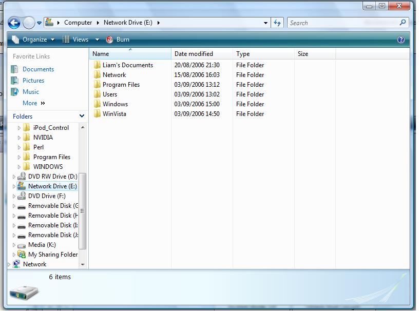

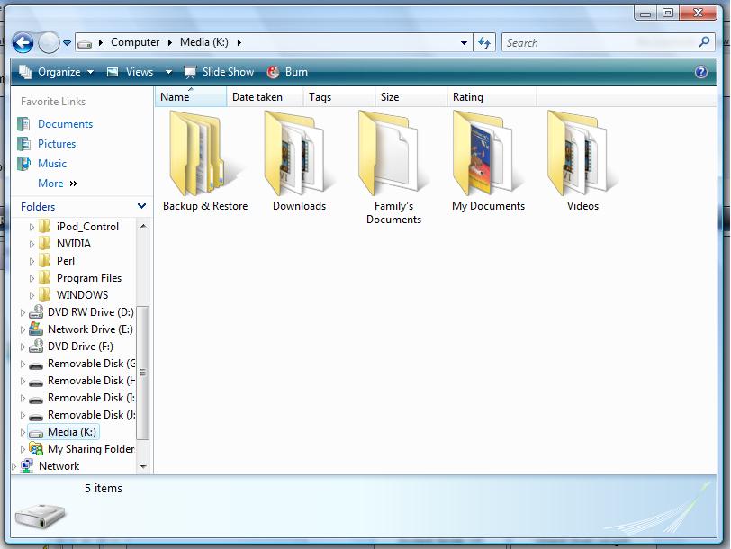

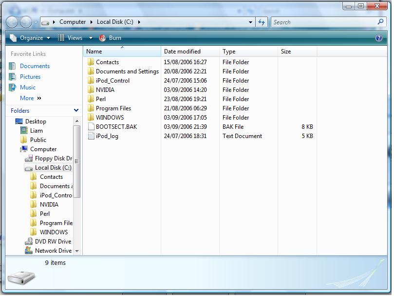

I am having problems with my NVIDIA GeForce 6600 LE & Vista RC1, The drivers RC1 installed as default. If I did a System rating tool to get my system rating (Control Panel\System and Maintenance\Performance Information and Tools, then click on Rate this computer ) it would go through the process and get about 60% through, the monitor then turns off and the system is still running... wait a few minutes and nothing hit return and get thrown the BSOD, which informs me it is the graphics drivers. I then uninstalled the drivers and downloaded the official x86 30mb+ drivers for Vista RC1 from Nvidia.com.
I then had the issue of Installing the drivers it said that I wasnt running Vista, I assumed it was to do with the install setup I have
C:\ Drive : XP
D:\ Drive : Documents, Media, Files + Backups
E:\ Drive : Vista RC1
I found that the RC1 Drivers had extracted into C:\NVIDIA\WinVista\96.33, and I assume it was detected XP as my default operating system, so I then copied over those Drivers to E:\ so it created C:\NVIDIA\WinVista\96.33 and then ran the setup.exe from that folder... same error... So I then decided to manually installing the drivers from device manager...and success! it worked... try the system rating tool again... same problem monitor switches off at around 60% wait.. nothing hit return and nothing no BSOD this time! my card worked fine with xp but I am now facing issues either GeForce 6600 LE isnt compatible with Vista or the RC1 drivers dont install correctly! but on Nvidia site it says GeForce 6600 LE is Vista Ready
How can I go about installing the setup correctly when dual booting, as I think this is the issue all files are not being installed properly as I have been forced to manually install.
As you can tell from screenshots below for some reason vista has the vista windows drive set as E and XP one is set as C :s and now D: has turned to K:
