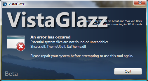

I just tried again and I'm getting the same error on x64
I see that I have a bit of work to do on the 64bit version. It's quite hard to tell if you are running 32bit or 64bit. I'll try to release an update in a few hours (when I'm at home). Unfortunatly I don't have a 64bit at home to test it on.
And i'll change the program logo to an image, I forgot that not everyone has the Chiller font :)
Thanks again all for testing.
I've created a new version 0.1.3
- 64bit detection should work now, and the files not found msg should be gone
- When the system or styles have state corrupt, "patch anyway" now really patches them
- 64bit/32bit mode detection happens before displaying a potential error (easier for debugging)
- Replaced the text logo with an image (Chiller font is no longer necessary)
- I disable the buttons after you press them to prevent double execution
64bit users, fire up your engines :)
