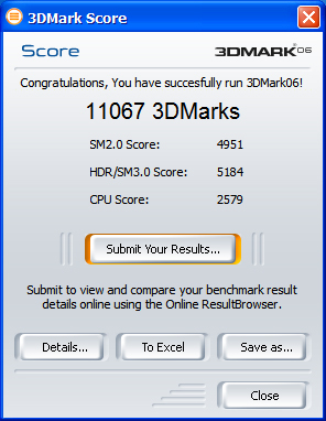

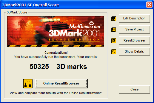

If u get around to it Radish, post ur 3dmark again with o'c as a comparison :)
3.2GHz would be more than enough for this setup, not using the stock cooler but an Arctic Cooling Freezer Pro 7. Currently using Corsair DDR2-5300, I also don't use Q-Fan or Speedstep.

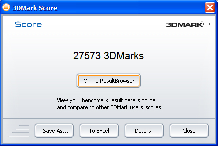

I think I know what was wrong - the ratio for the RAM. It was running at 5:4, but it doesn't make sense that one of the sticks would be faulty (thought both would be bad).
Anyway, got it on track now with the image attached :D

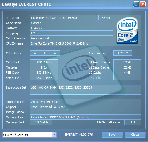

EVEREST CPUID -
https://www.neowin.net/forum/index.php?show...amp;p=588602651
