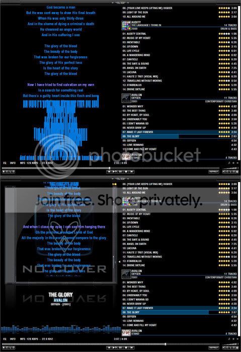

This happens when I'm using the lyrics over the album art feature.
Changing to the lyrics panel, gives the first effect.
changing back to the album art panel gives the second effect.
It looks like lyric show starts forgetting to repaint the background outside the area specified by the album art panel.
Is this a problem with the lyrics show plugin or something that can be fixed with the PanelUI scripting?
