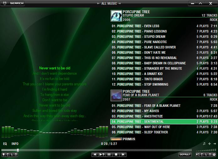

I can't get it to align with the reflect, no matter how I resize the foobar window, what could be the problem? It was normal on my first installation.
In the code for the album art panel (rightclick on the panel and choose settings), about half way down is the code for placing the reflected spectrum. Probably the easiest way to find it is to copy the entire page of code into notepad and search for vis.reflect
The lines you're looking fore are:
$panel(Spectrum analyser4,Channel spectrum panel,1,$sub(%_height%,122),$eval({%_width%}/2+3),35,)
$panel(Spectrum analyser14,Channel spectrum panel,2,$sub(%_height%,86),$eval({%_width%}/2+3),25,)
Notice the 1 and the 2 after "Channel spectrum panel". Those are the horizontal position.
To make them align change the 2 to 1 or the 1 to 2 so they're the same.
There are a few other spectrum analyser blocks on this page of code. You can take a look at those and make minor changes there also to see if it changes what you want.
Always good to have a backup of the code in notepad or elsewhere in case you can't figure out how to get back to where it works if you broke something.
Personally, I usually leave the spectrum off because of the extraordinary amount of CPU time it demands (added my own $ifequal($getpvar(vis.reflect),1, at the around the spectrum blocks so I could use the reflect option in settings to turn it on and off)

Thanks for your reply and very informative help :)
Though I don't even seem to have that specific piece of code in the album art code (I right-clicked on the cover art and chosed settings). I did a search in notepad for "vis.reflect" and "Spectrum" but they gave me no results. Can I put in the code manually?
Thank you once again for taking time to help me :)

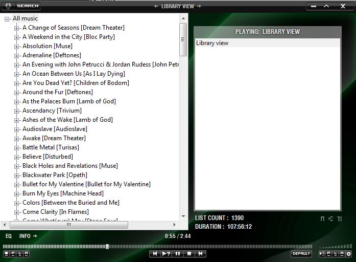

Hey guys,
I just got this script installed but there's one thing I can't figure out: why the library isn't working. I went into Setttings>Media Library and added my the root folder of my music library, yet when I click the 'A' on the bottom right for 'Album List', it only displays the album that I'm currently playing, like so:
What am I doing wrong? Also, what is quick search and how do I access it?

By coverflow you mean does it show album covers properly? I don't get any text errors, but it still doesn't work right. For example, when start the playback of an album (through the default ugly album browser, since the graphical one doesn't work), it momentarily flashes the correct album cover and goes to 'no cover art' right afterwards.
Graphical Browser displays active playlist only. This is how foo_uie_graphical_browser works. Covers for Chronflow should be called "folder.jpg", you can change it in Preferences->Display->Chronflow->Album Source->Sources
So what you're saying is that FooAva doesn't allow for a sexy album library browsing interface, only for the current/active playlist?
