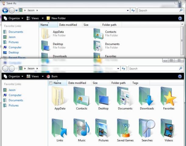

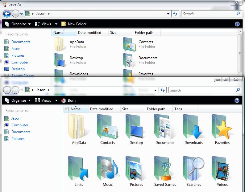

From my obserations, folders seems to misbehave when or after I browse to them via program Open or Save As dialog boxes. Any program, whether Photoshop or MSPAINT or MS Excel. Yes, I had to delete those bags keys from the registry to reset these folders to default like it really worked perfectly in XP.
Have a look at this screenshot, this is a Save As dialog box with my Personal folder open in MS Paint and a Explorer Window of the same window. Notice how different the icons are. In MS Paint it's Tiles but in the Explorer window: Thumbnails. This is not the only folder that does this. Even ones in the C:\Windows folder.
Confirmed.
To reproduce, set the folders to large icons. ??Open MS paint, click save as, select the home folder then close the window. ?Click computer, then the home folder again and you should have 2 explorer windows of the same folder with different views.

Well the issue is that that ICON VIEW settings (large,small, list, etc) is being reset when opened in a save-as dialog.
