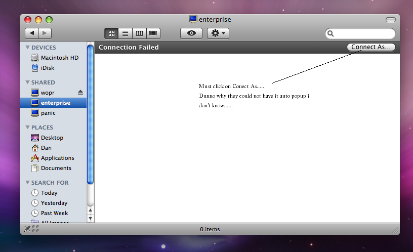

i got it figured out
with tiger i am used to it poping up a login box asking you to login but with leopard it looks like they removed that wonderfull feature and replaced it with a connect as button.....
They removed it because you don't always need to login to get to a share.
I can browse the PCs (some XP some Vista) on this network without a password. With a password I can access a little more.
