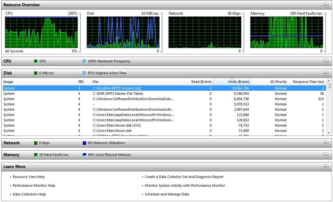

From what you're saying, it's just a case of your hard drive's seeing a heck of a lot of usage. (I think the first two examples of what you're seeing are System Restore and the Shadow Copy Service, DON'T turn them off, they're very probably a symptom and not a cause)

I just downloaded all the newest drivers and it made no difference at all. Also, I'm adding a picture of what the resource monitor looks like when this is happening. All those blue spikes are stutters, the other graphs are sometimes high, sometimes low, but it never seems make any difference. The green on the disk is also sometimes high and sometimes low, and still no difference. Sometimes the stutter come rapidly like this, sometimes they're nearly continuous and don't drop, and sometimes none at all for several minutes. The blue line on the disk can be high for a legitimate reason without causing a stutter, but the blue line is always high for a stutter. I don't understand why the hard drive would be getting a lot of use when everything else seems to indicate that it is not, or at the very least that the stuttering is independent of standard use.
