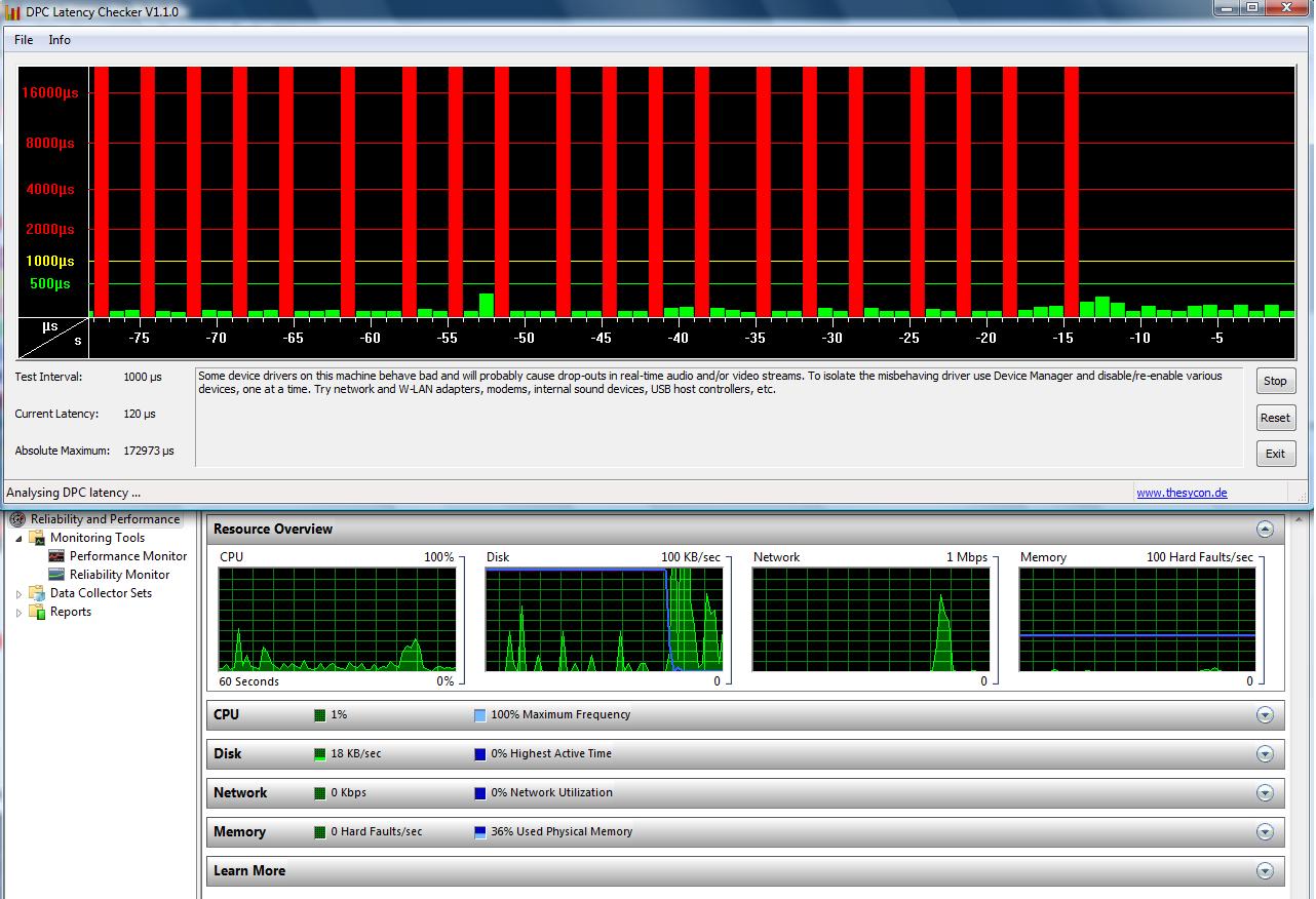

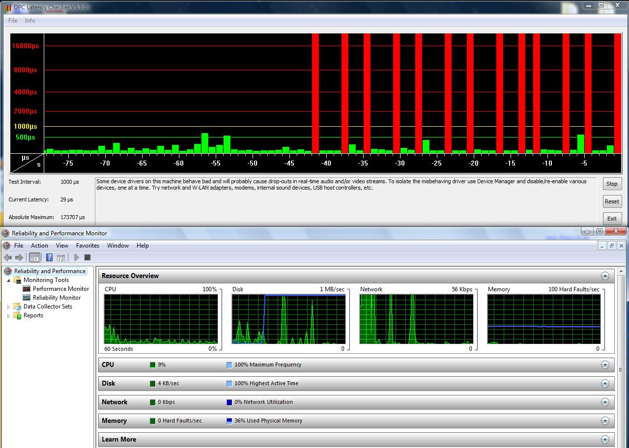

Ok, I followed your suggestions but have to admit that I only have a partial understanding of what they're talking about... Anyway, the DPC latency checker shows massive spikes repeating regularly every 3-4 seconds, and corresponding perfectly with the % highest active time (see below). The process explorer during this time kept popping up 4-8% CPU utilization spikes for the DPCs that seemed to correspond with the DPC checker. The website you pointed me to suggested disabling a number of different devices, the only two of which I have are integrated sound and network. I tried disabling both during a round of stuttering but didn't see a drop, though I'm not sure if it should be immediate or not. The stutters still seemed to last about the same amount of time as they always did though. The only way I can consistently initiate the stutters is by accessing the network (I would say internet except that it happened accessing my router through the web browser as well), and I was still able to initiate it after disabling the sound, but even if the network connection isn't the problem I don't know how to initiate it without using the network, so I can't get it stuttering while the network is disabled. Just to reiterate (because I know someone is thinking it already :) I have already tried all of the latest device drivers to no avail.

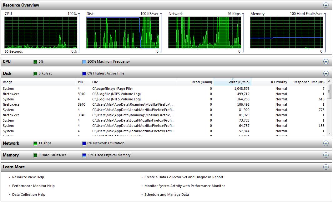

Here are the performance monitor and DPC latency checker graphs for the beginning and end of two different batches of lags:
Hmm, very interesting. Massive Q'ing of interrupts going on. Those interrupts must be coming from somewhere. From what you described, I can only imagine it coming from the disk or the internet connection. I have to think about that (it is 1.30AM in my neck of the woods). I will get back to you tomorrow. In the meantime you could check 2 things:
1. Get off the router and connect directly to the modem. Just to eliminate the router as one source of the problem - (the modem being the other possibility).
2. Check the OS disk (I assume that is C:) for errors. You can do that either in the C: Properties > Tools > Error Checking or in Command Prompt with CHKDSK C: /R - or any other good method you usually use.
