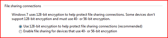

I noticed an option to alter file sharing encryption settings to 128bit or 40/56bit. What does XP use? I wondered if perhaps (by default) it uses no encryption at all and that's what causing all the problems. Note that I do not use a wireless connection as I have a wired LAN.

Given that I'm using a wired (not wireless) LAN, where would I find encryption settings on my XP machines?
I meant this
Found here : Control Panel\Network and Internet\Network and Sharing Center\Advanced sharing settings
I meant this
That has no bearing on this bug dhan. The 7057 build definitely has a problem networking with XP. It connects but shows no icon(s) for the XP machine(s) in the Network window. The only way you can browse the network is by typing in the path manually. Changing encryption settings makes no difference to this.
