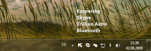

Btw. What do you mean by the sign out icon of messenger? After a quick peak at msnmsgr.exe it only seems to contain some icons, not the status icons. Another icon in different sizes is contained in ctticon.ico. Looking in msgsres.dll I found the status icons at least (extracted them and attached to this post).
Note that this file is patched by apatch so if you use that you should patch it after apatch has done it's thing.

I don't like the icons being all monochrome... it's harder to distinguish them. That's why colors are good for icons.
The wireless reception bars... I was expecting something green, I even thought the connection was broken.
They're stylish, yeah, but I still think having colors would help distinguish things.
+1
I made a few quick samples of the icons for Live Messenger that I uploaded earlier. Tell me what you think. :) I plan to try them out tomorrow or whenever I get the time. Shouldn't be a problem to reshack them into msgsres.dll though.
wlm_status_icons_white_blunden.zip
I took the time to do the rest of them as well, 14 in total. I've included all the ico-files in the attachment to this post. I also made a modified msgsres.dll (needed for it to work) but unless I know it's okay to post it I will not do so. I already made the mistake of posting a modified user32.dll.mui a few months back.
Btw. Why is the edit function time limited? I feel like I'm spamming. :(
wlm_tray_icons_white_blunden.zip

I'd like to go with the all white system tray icon look as well. I assume that some people are using a resource editor to swap out icons? If that is the case - would anyone point me out to the best software and method to do this?

I use Resource Hacker. It hasn't been updated since 2002 but it still works just great in modern OS:s. After you open a file, check under Icon and then right-click and select Replace resource (or Replace icon, I don't remember). It will then open a dialog box where you can select the icon to replace. When done, just save the file and replace the original.
