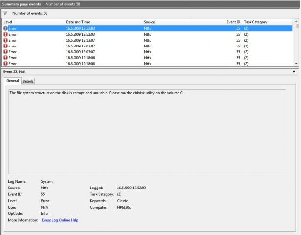

Very often chkdsk.exe launches to check system partition even though it had shut down cleanly, by using Shut down opton in the Start menu.
I'm running Windows 7 RC X64; I can't remember if it happened with other builds.
Roughly, every second startup is affected with this issue.
This is my last and before last log:

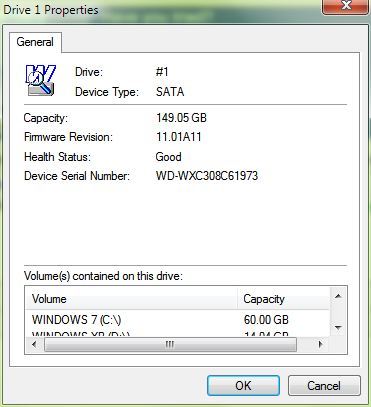

My machine:
HP 6820s
WDD 160 GB
DDR2 2GB
ATI Mobility Radeon X1350
Intel pentium Dual Core T2390
I have installed all latest drivers offered from WU.
I've tried running chkdsk from Win 7 install disk (from Command Prompt) on all partitions (with /f parameter) but apparently it didn't help.
Any ideas?
Thanks!
