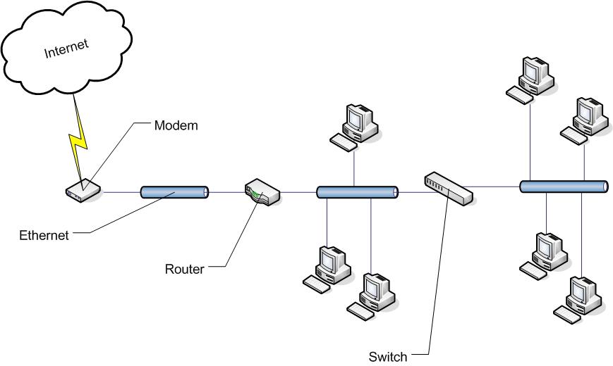

In a normal setup would quite often look something like this.
Now your modem and router might be 1 device (gateway) Or you modem might be on the wall provided by your ISP (internet provider).. You might have multiple switches, you router might not have multiple switch ports (so no computers connected to it). etc. But this is pretty much a basic drawing of a simple basic network.
Most soho (small office, home office) would have a NAT router, ie it would change the public IP given to you by your internet provider to a private one (192.168.x.x, 172.16-31.x.x, 10.x.x.x) And allow you to share 1 public IP with many computers.
You internet connection is most likely DSL or Cable? So again if you could give us the model numbers of your devices, or any devices they connect into on the wall, etc. That would be great -- and a basic drawing showing showing how things are connected would be great! Does not have to be fancy!! Just something showing us how everything is connected, where computers are connected, where the internet comes in, etc.

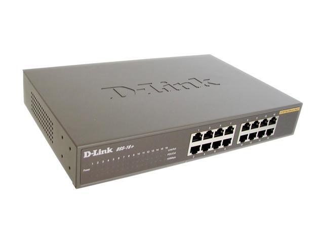

http://img2.pict.com/2d/de/e3/1631860/0/picture.jpg
One of the dlink or linksys has to be a router, or a gateway (modem/router combo).
I have confirmed that both are switches by their model numbers.

Yeah from that picture that dlink sure looks like a switch, pretty sure its this one. DSS-16+
So the router is in the other office, and there much be a connection that runs from that router to one of these switches, and then the switches are connected together?. The linksys SR2016 is a 10/100/1000 switch while the dss-16+ is only 10/100

Yeah you clearly do not need both cables -- they are all on the same network 192.168.1.0/24
You could clearly clean this up - and remove the 2nd cables.
A machine only needs 1 interface in the same network.
And they point to the same gateway -- 192.168.1.1, which would be your router. I have no idea why the guy before you would of connect a machine twice to the same network, other than they had no idea what they were doing.
edit: just noticed yeah your server has wired and wireless connection - pointless! And yeah I would remove the older 10/100 switch from your network. Since the other one is a 10/100/1000
Also to be honest the only devices that need to be on wireless are ones that are harder to connect a wire too, or laptops that want to move around, etc. But you would normally never have both a wireless and wired connection at the same time.. And yes can cause issues to be sure.
And that is not server ;) its a XP box - so for starters your going to be limited to only 10 concurrent connections at a time.. Sure you can use to share files off of, etc. But as already suggested you would have much better control with a Active Directory setup - if cost is an issue. You could use something like ClarkConnect as your server - which could act as a Domain Controller, etc. So that you would have central userbase.
Also as mentioned with that wireless router -- I hope its secured? WPA or better yet WPA2, you could look into setting up enterprise auth (radius) vs PSK, etc..
I would clean up your wiring first, and then think about moving to a domain, and then evaluate your need for wireless and how to best secure it for your needs, etc.
