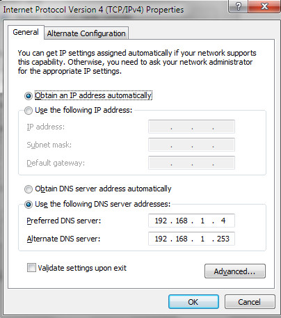

If you don't want to use dns from dhcp - then dont.. Just change your clients to get the IP, but to use a static dns server. Just change that on the properties of your wireless interface.

I can't set a static dns server in the TCP/IP settings because so many of the people on my floor have to go to different schools or travel, which once again have completely different IP scopes.
