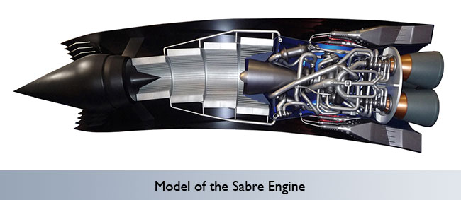

The SABRE engine is a combined cycle rocket, not a jet or scramjet.
At high speeds in the atmosphere it breathes air, liquefying it on the fly to support combustion in the rocket thrust chambers (several per engine.) At liftoff & low speeds and outside the atmosphere it uses stored liquid oxygen stored in internal tanks. This minimizes liftoff mass while maximizing the payload mass.
In both cases the fuel is liquid hydrogen stored in low boil-off tanks in the airframe.

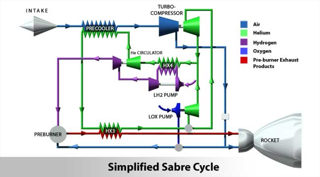

Just to keep diagrams up with the story - here's a longitudinal section of SABRE and the fluid cycles. The critical component is the pre-cooler, which is made up of the 4 silver cylinders in the sectional image.

What does being able to rapidly cool air have to do with extremely fast flight?
All fluid flow, if assumed a continuum and constant viscosity, is governed by the Navier-Stokes equations. The three sets of equations are continuity, momentum and energy. At most speeds under say, Mach 0.3, we can generally ignore the energy equation because we can assume the density remains constant. This "decouples" one equation from the three, so we can decouple the energy equation since we only have two unknowns and two variables, pressure and velocity. At higher Mach numbers, compressibility becomes more important and we can't assume a constant density anymore. Moreover, at very high Mach numbers, say M = 5 (hypersonic), the flow regime is dominated by heating effects. I have never studied hypersonic aerodynamics but I'm sure you'll appreciate, with re-entry of the space shuttle for instance, the vehicle speed s substantially high such that the aerodynamic heating effects are very important - hence one reason we might have to cool the materials. In terms of the air, we may have to cool that so that we can actually slow it down fast enough to react with the fuel - at least that is what they do in ramjets. Bare in mind too that the higher you go in the atmosphere, the less true the assumption of a continuum holds, and you begin to enter low density flows or even free molecular flows so this will all change the properties of the flow regime.
The power produced in an engine depends largely on the quantity of fuel burned with the available oxidizer (air, liquid oxygen, nitrous oxide etc.) in it the engines combustion chamber(s.)
Roughly, more fuel burned/second = more power produced = more speed.
In air breathing turbojet engines this fuel quantity is limited by the density of the air breathed in after it's compressed by the turbines. However, no matter how good the turbines are the air will always be a gas.
In a SABRE engine the air breathed into the precooler is supercooled into a liquid, massively increasing its density and therefore how much fuel can be burned with it. It burns the fuel / oxidizer mix in an array of rocket thrusters.
At 85,000 feet it runs out of enough air to be useful so SABRE switches over to liquid oxygen stored onboard before launch to run its thrusters. This makes it a dual-cycle engine. When in this second cycle it can fly in space.
Why a dual-cycle? By using atmospheric air for the first cycle the amount of stowed oxidized for the rockets is reduced, which increases the amount of cargo that can be flown.
