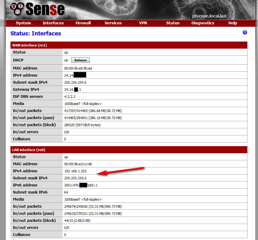

What?? Post a screenshot of your dashboard or interfaces screen

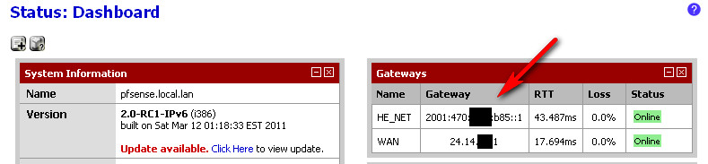

Been running pfsense for years now, currently using 2.0 rc1 and setup the ipv6 development stuff from 2.1, etc.
So lets see the output of your status interfaces screen so we can see what we are working with - feel free to block out the last couple of octets of your wan side.. But need to see that your on public IP on wan, and private on lan, etc.

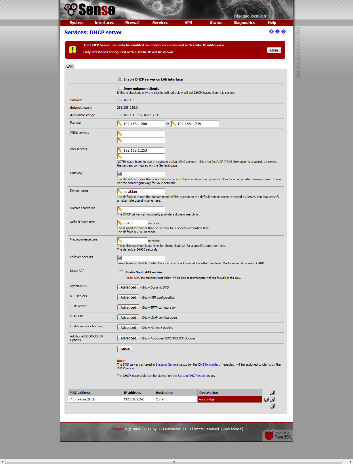

ok so here is output of dhcp server.. this means that it will hand out IPs between 192.168.1.200 to 239, it will also tell clients to use itself 192.168.1.253 as the dns server, and that local domain is called local.lan

Well no **** that will never work, you have the same exact network on both the wan and the lan.
Your clearly behind a NAT device with that 192.168.33 (Private) network on the wan side.
What is your pfsense box connected to?
why did you set a /25 bit mask on your lan side??? Where did you get the idea to use 192.168.33 on your lan network??
Lan card? And you don't have a modem you have a NAT router, I don't care if they call it a modem or not?? Its doing NAT!! you got a private IP.
What is the model number of the device your psfsense box is plugged into?
And where did you plug the lan side into?? Into the same "modems" lan ports?
