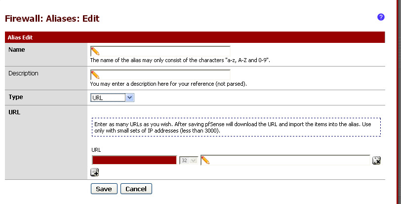

edit: now you could create a alias for the url that should work
So if only a few domains you could get by with this I would think.

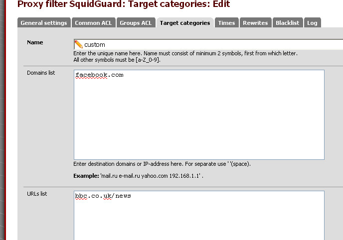

edit: ok installed the package, went through the instructions for squidguard, not even using blacklists
Then
created custom list,

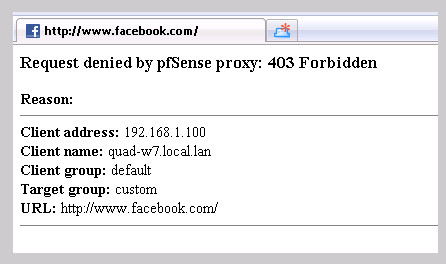

And put in facebook.com and looks what you get
  • Like 3

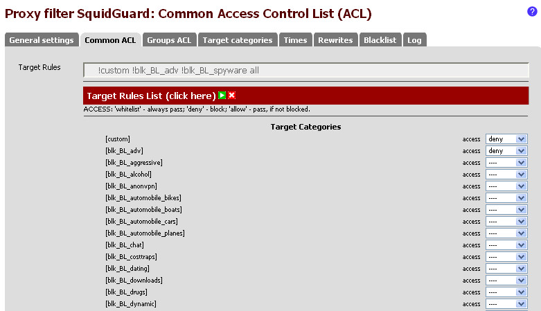

to get blacklist to work, once you have downloaded and picked what categories.. make sure on the bottom of general proxy filter page you put in the location LOCAL
note: bottom of page says
Enter FTP, HTTP or LOCAL (pfSense) URL blacklist archive, or leave blank.
Once you have a black listed loaded under targets you should see all the categories and you can set to block, allow, etc
also make sure once you make any changes to anything on the proxy filter to hit the apply button in the general proxy filter page and then save. Working smooth as silk here!
Then

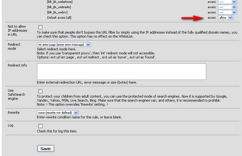

It just isn't working, i disabled the blocklist tried a custom filter everything is blocked.
What is in your custom options?
you have to set default to ALLOW if using squidguard.
I posted options off squid page in the post above on an edit.
