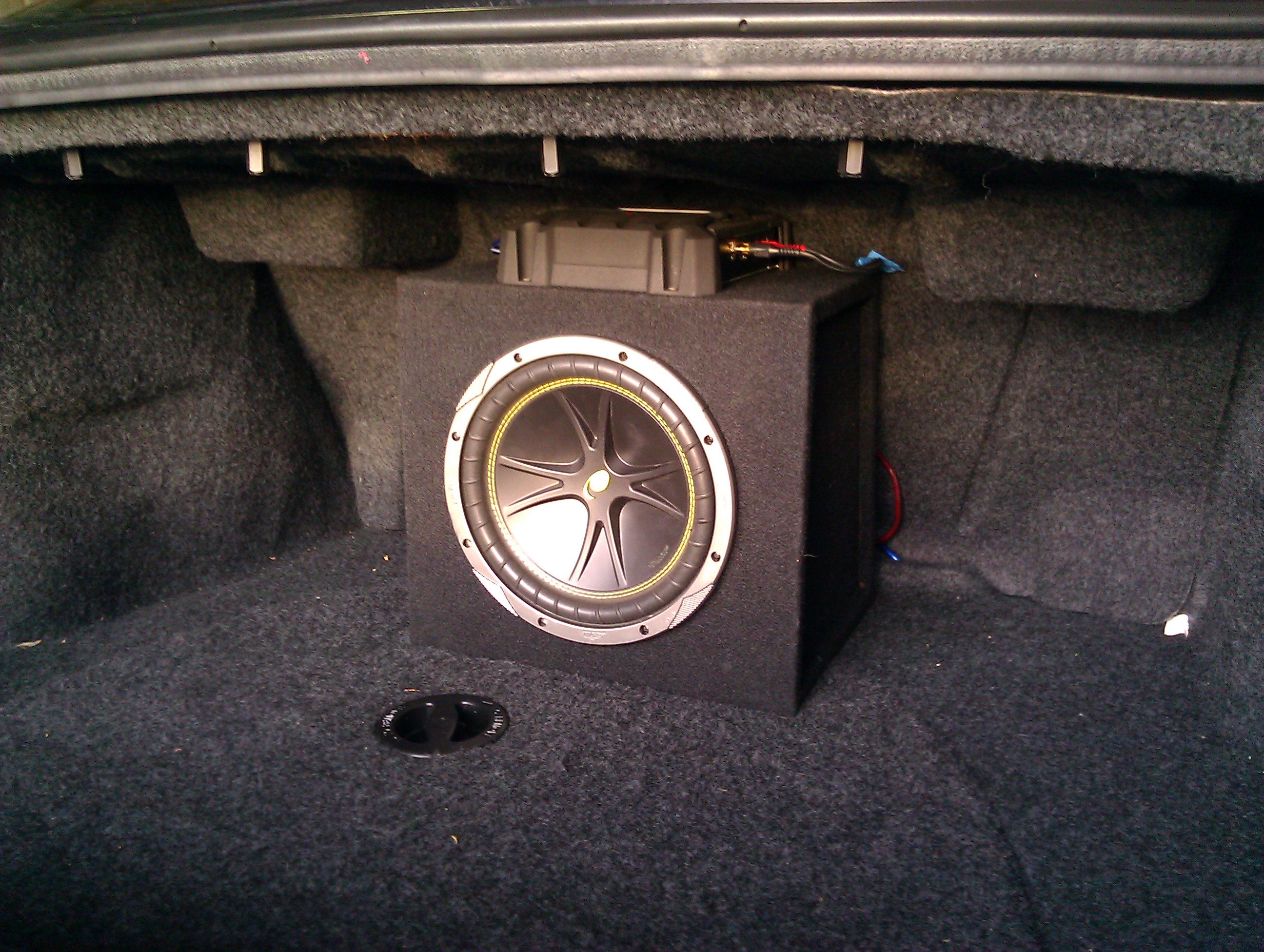

For the past couple of weeks I have contemplated buying a subwoofer for my car... I didn't want anything HUGE, as I don't it to over-power my speakers, I am just an amateur and want a bit more sound quality. Today, I purchased one!
For starters I got a Panasonic deck (not sure of model) with two MTX audio speakers in the front and two kenwood speakers in the back... I bought those at different times and only when there was a good deal. They perform wonderfully for the price I paid
I just purchased a 500 watt RMS clarion bass with a 500 watt RMS kenwood amp and a custom made box, should arrive within the next week, super stoked to get it all set up...
Here are links to the specific models I purchased:
http://www.clarion.com/ca/en/products/2011/audio/subwoofers/PXW1251/ca-en-product-pf_1259499534022.html
http://www.kenwoodusa.com/Car_Entertainment/Amplifiers/KAC-8105D
I ended up getting a little more power than I wanted, but it shouldn't hurt, as I said the MTX and kenwood speakers I can get to go pretty loud without distortion using just the aftermarket deck...

I've got stock chevy speakers (which are probably the best stock speakers in a lower model car dealer you can get), with 2 12 inch 1400watt Pioneer subs, and just a little 300w amp, one day i'll upgrade so I can get the full 2800 watts for the 2 subs. It's got lots of kick now as it is though.
Pretty nice for a first system OP... I've got a Kenwood KDC-x993 head unit, a pair of Rainbow SLX265 6.5" components, all hooked up to a MBQuart DSC480 amp. Sorta looking for a sub.... but sounds pretty good for what it is.
Not to pick on your purchase but your setup will be a typical boomer with very little sound quality. The sub you bought is for SPL not quality. The amp is fine but way more power than you need for a "didn't want anything huge". Your door panels and roof will be rattling bad in about 3-4 months. Just buying brand name aftermarket will usually blow away most factory stereos since they almost universally suck. They are getting better but very few use decent drivers. Anyway, your system will boom a lot. Try to play with the position of the sub, facing the trunk, facing the side, facing the seat, etc to get the best sound. Just aiming it at your back my not be the best sound you can get. It all depends on the type of bass you play, how far from the sub you are, the size of the trunk etc.
IMO stay away from anything Kenwood, they are kinda like the Ultra of car stereo.
Oh, my setup, Alpine 10, Eclipse headunit, pioneer elite 4channel, infinity 5.25. I was a custom installer for 3-4 years, pretty much used every brand out there in the 3 shops I worked for.
Oh, one question, did you get a ported or bandpass enclosure?
Thanks a lot for your input, but yeah I DIDN'T want anything that would boom, but I failed to mention I got a FANTASTIC deal on the sub/box combo, too good to pass up, $150 for the pair (and free installation which costs about $80 here) - my friend started working at a car-audio place for the summer and he got a great deal on it for me -, so I went with it even though I didn't want something so powerful. And it is a ported box.
I plan on keeping the sub turned down fairly low, I will experiment, and again if it ends up booming too much, oh well, I spent $150, I can resell it for more. When I do look into getting a real car audio system (when I get my own car - as I said I am amateur right now and just starting out) I will be spending a lot more cash and will keep in mind the advice you gave, thank you again :)
Not to bad but ported is going to be loud as hell :p What kind of music do you listen too? Sealed is better if your into quality and clarity in your sound, I listen to a bunch of metal and rock with very little rap/hip hop and sealed is perfect ;)
