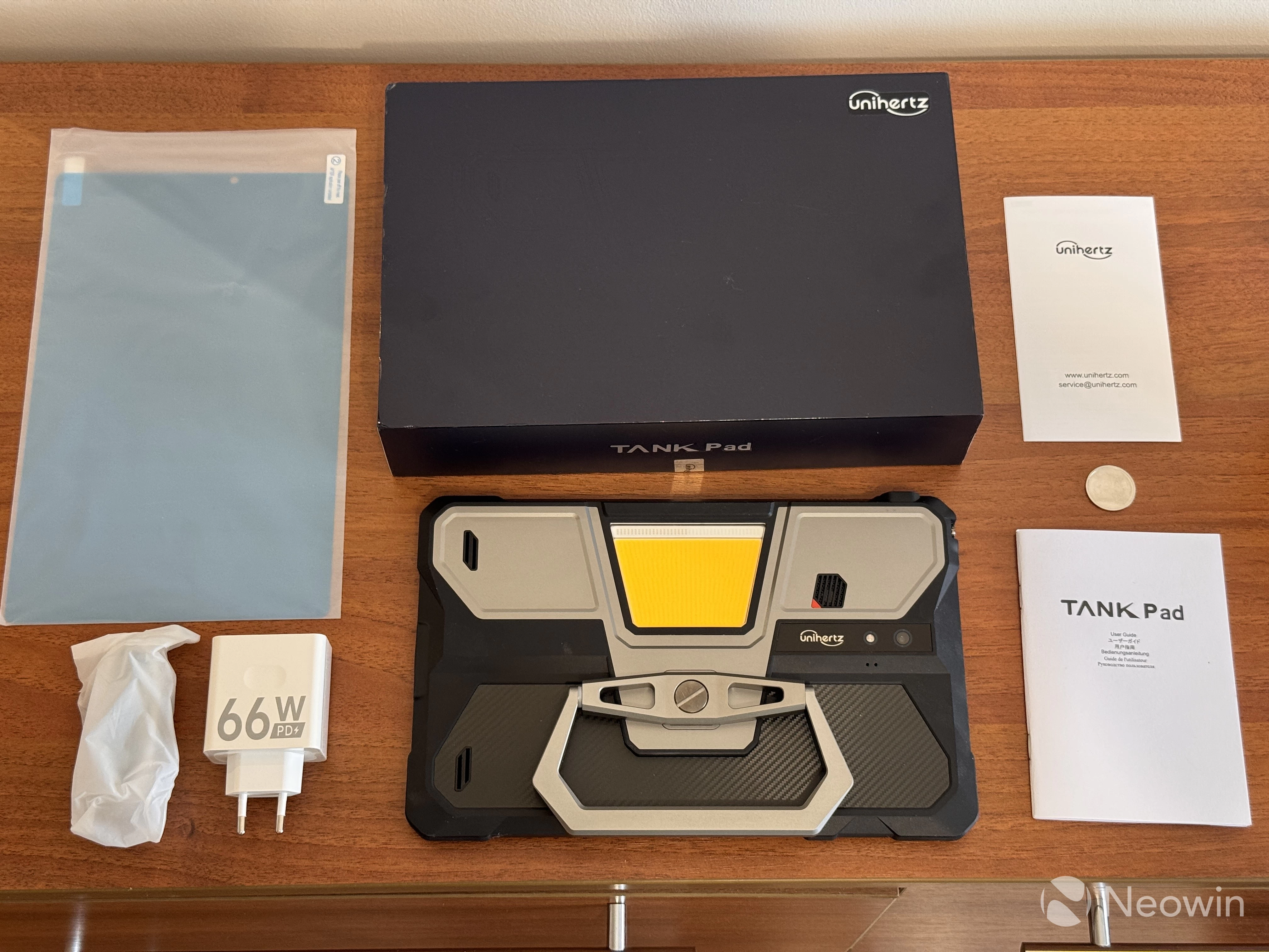

The TankPad arrived in a high-quality black box and a good set of accessories. Inside the box, you will find the following:
  • The TankPad itself

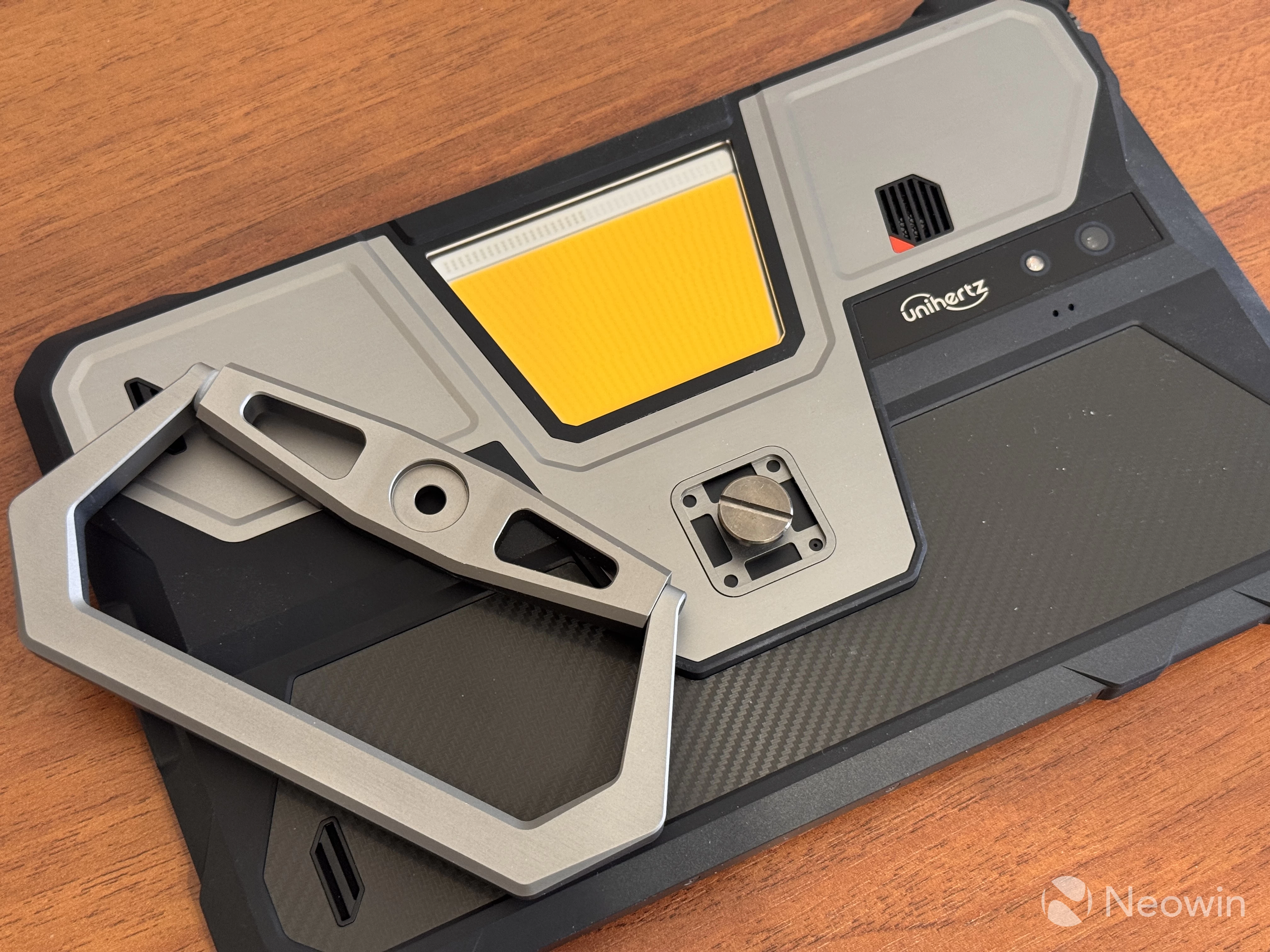

  • All-metal stand that secures with a coinscrew
  • An 8849-branded coin (to help you screw in the stand)
  • A 66W charger with a Type-C connector
  • A USB-C cable
  • A spare screen protector (one is pre-applied)

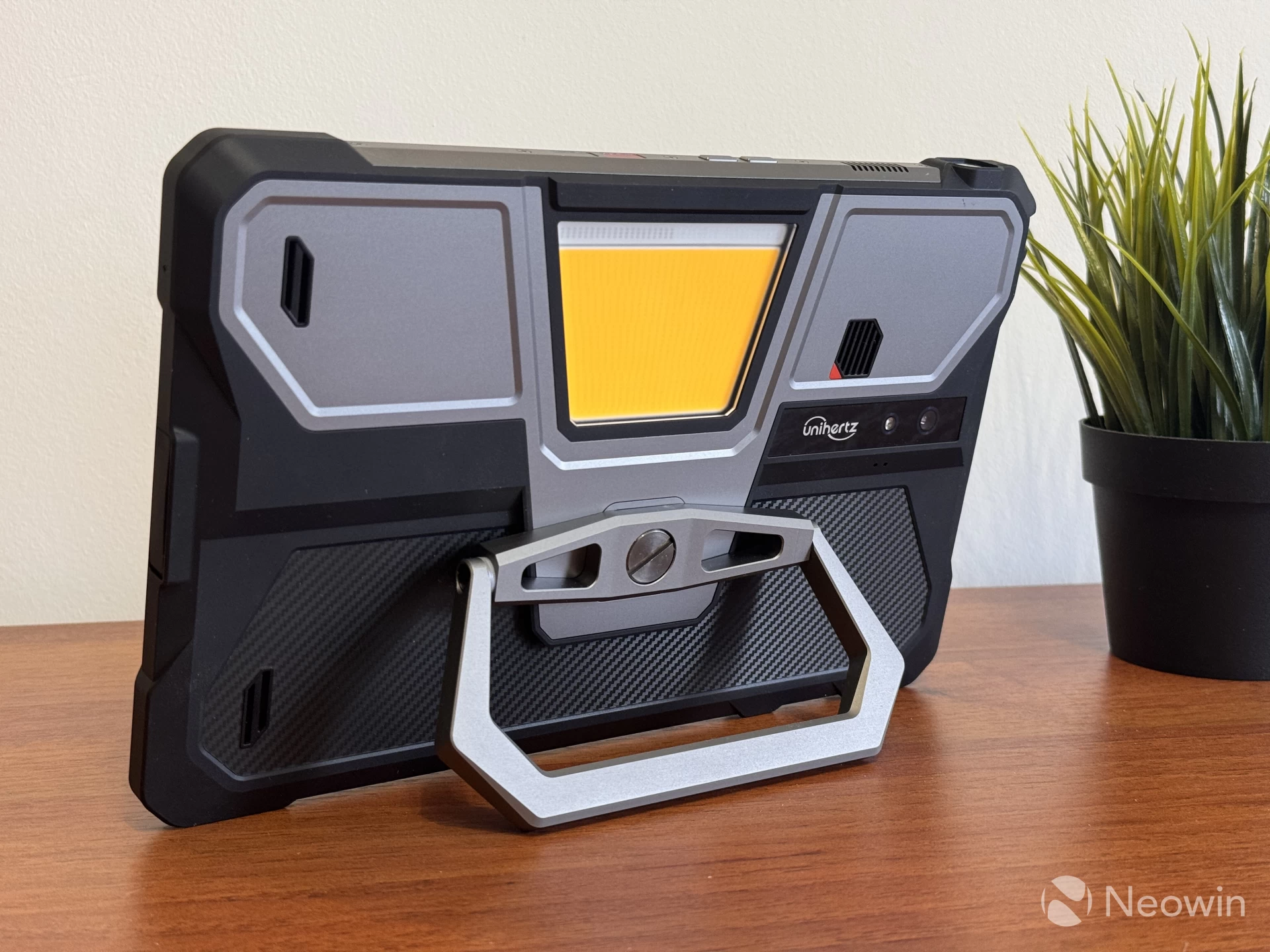

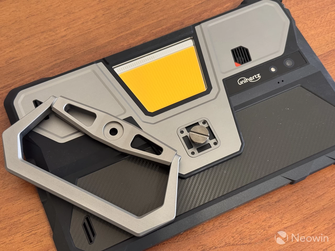

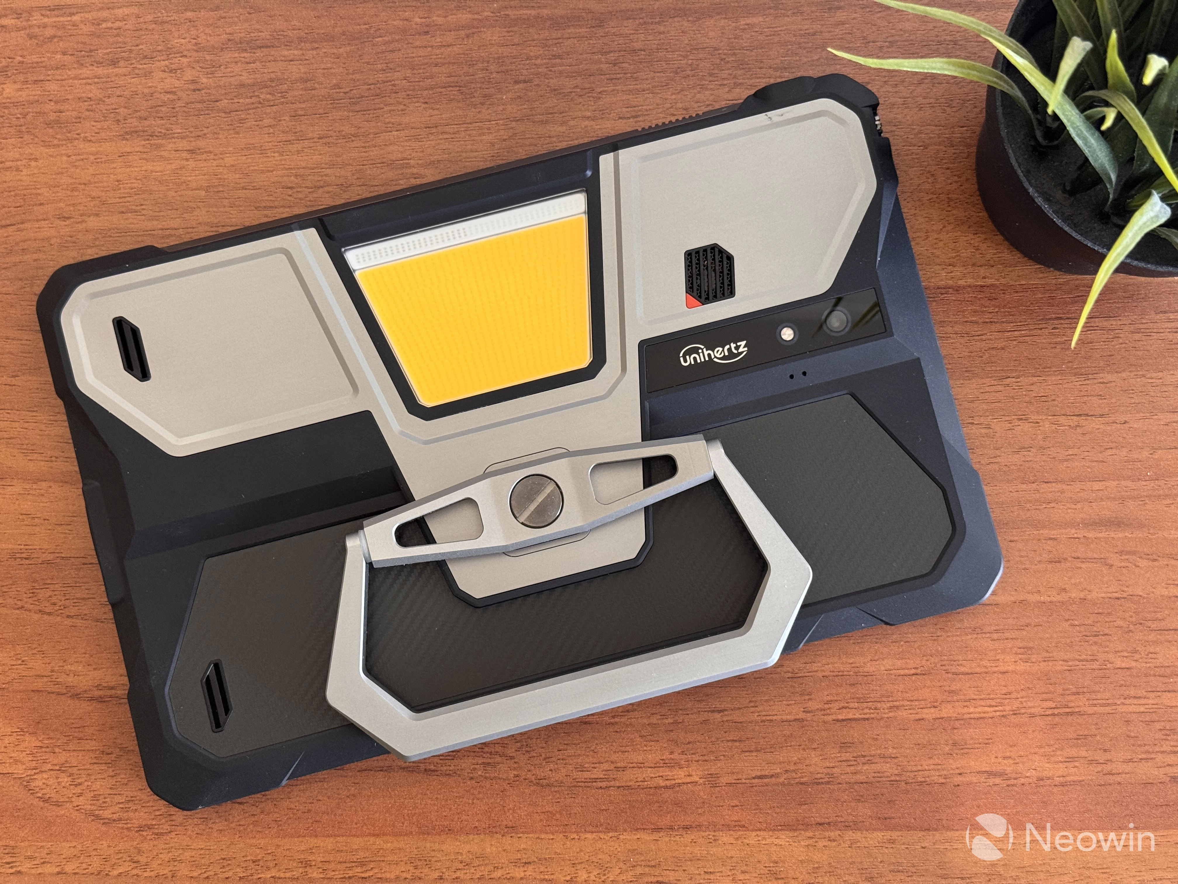

The first thing that strikes you the moment you unbox the TankPad is its weight. At 1.25 kg (with the stand attached), it feels like a brick—heavy, rugged, and very dense. It is built with a mix of rubberized plastic, metal, and what looks like carbon fiber. The latter adds character, and it looks quite nice for this kind of device, but I suspect it is just stylized plastic.
The Unihertz TankPad tablet

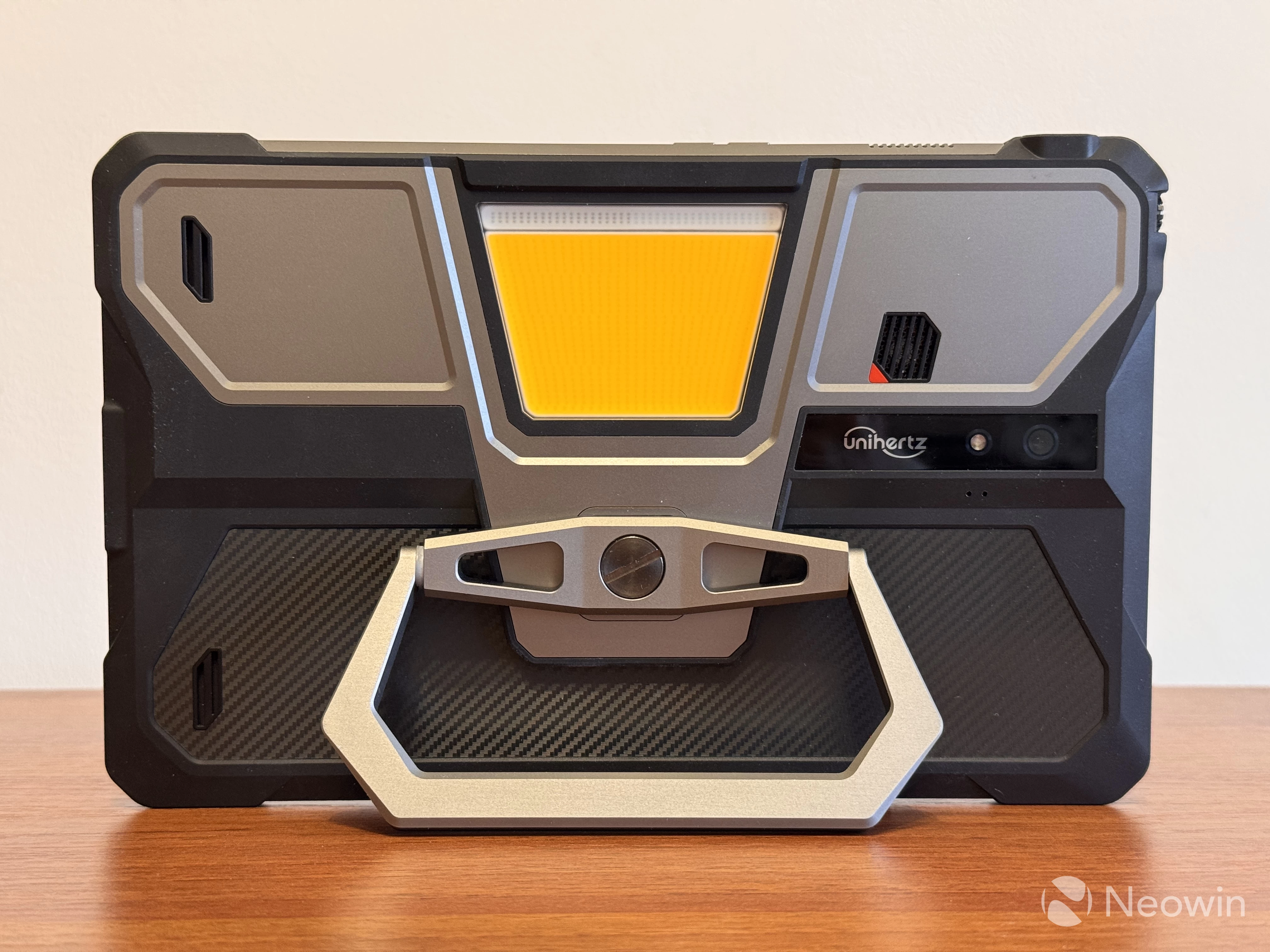

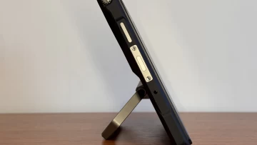

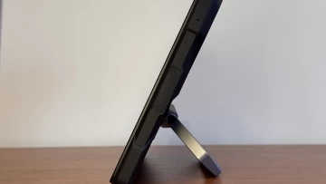

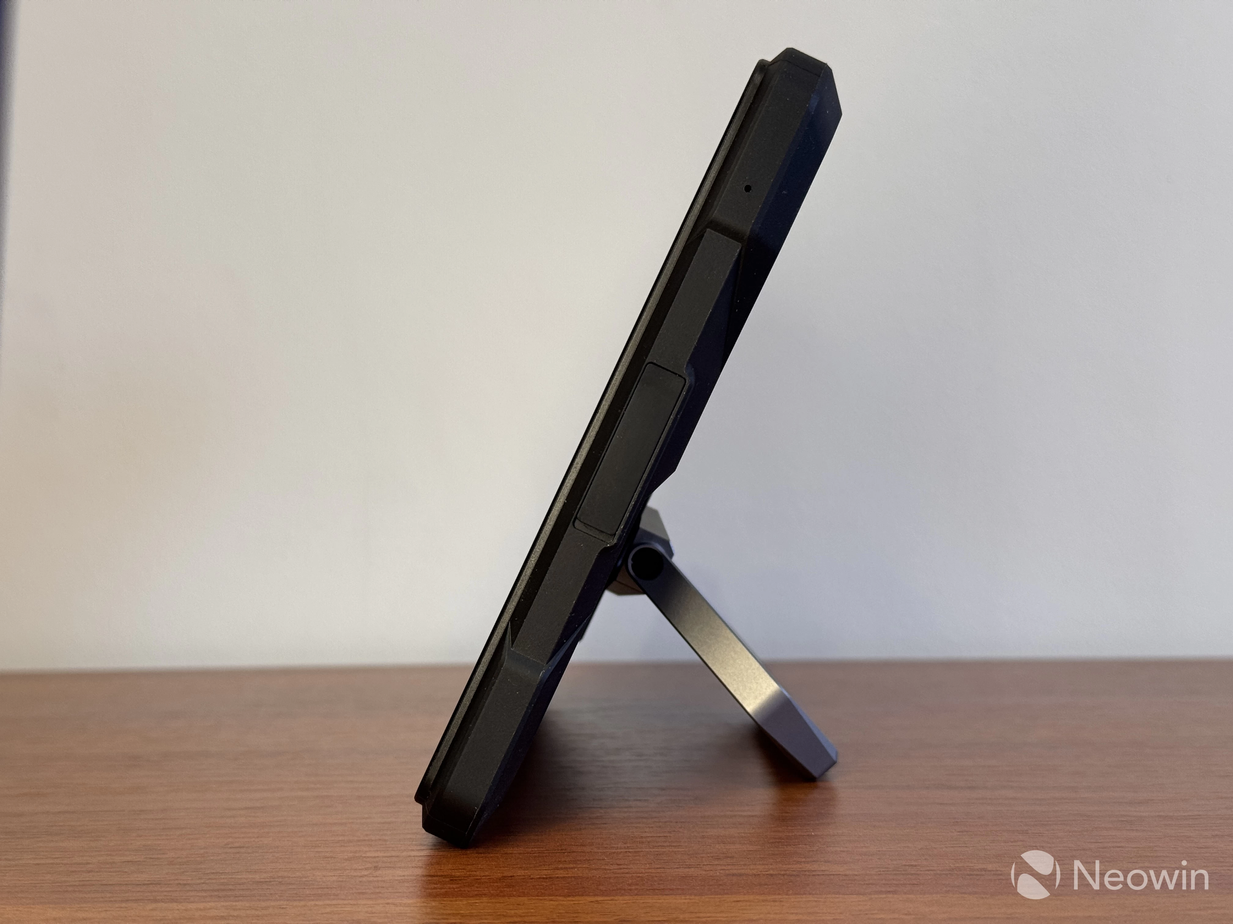

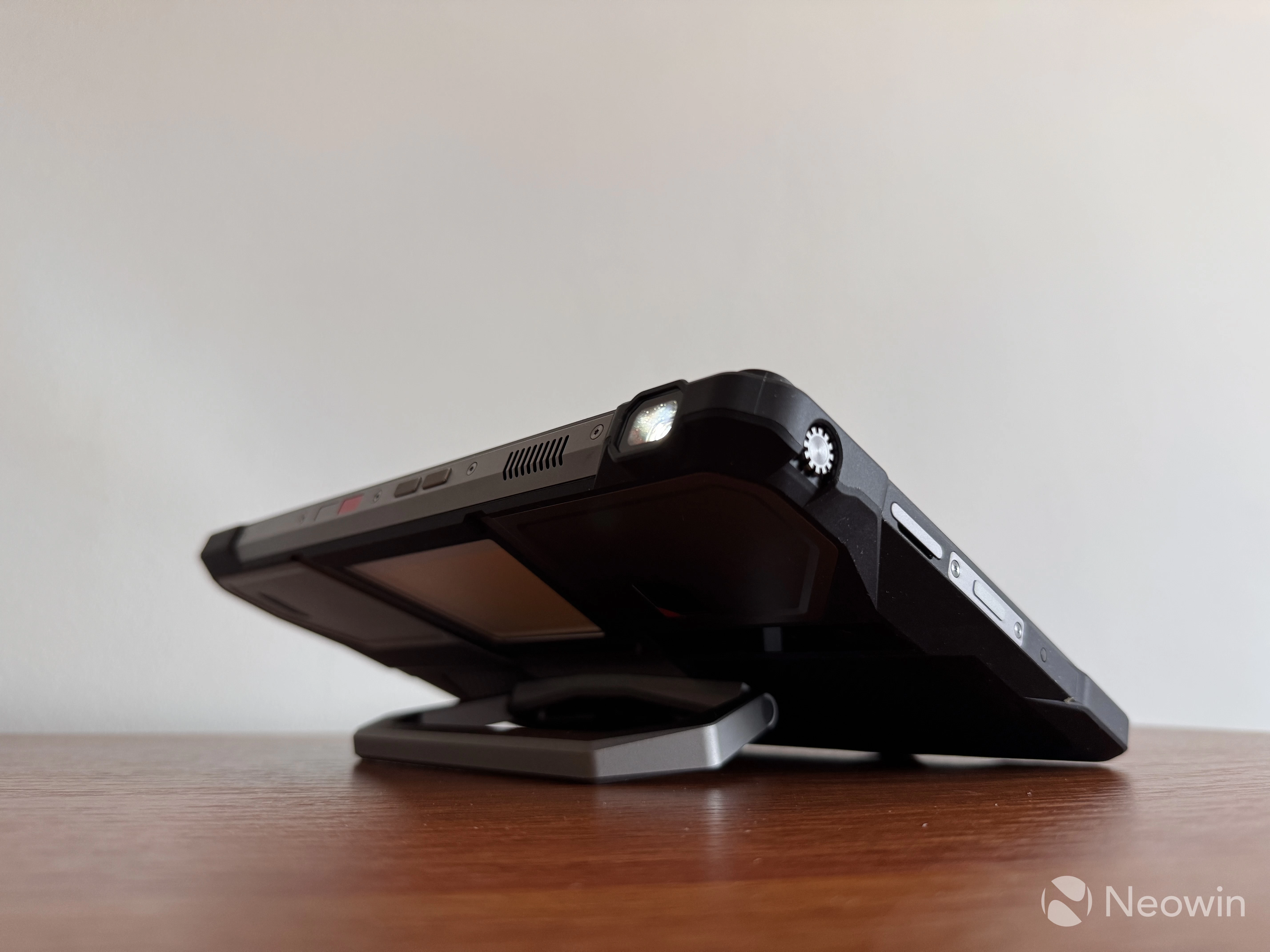

The kickstand is heavy, and its hinge is super-stiff, so forget about adjusting it with one hand. Pressing hard enough can actually damage your table surface. All four corners, including the projector lens, have additional plastic cushions to absorb shock when dropped. 8849 says the tablet should be good after drops from up to 1.5 meters, or 5 feet. I dropped it a few times, and to be honest, I was more worried about my laminated floor than the tablet—the metal kickstand could do some serious damage when handled carelessly. Funk dancing Android tablets for self-defence? Why not.
The build quality raises no concerns about durability. These are not just tough looks; the tablet feels buff. IP68 and IP69 ratings also mean you can submerge this thing into water all the way to 1.5 meters for 30 minutes, plus it is protected from dust. After swimming in water and spending some time in sand or dust, the tablet can expel water from its speakers and fan using special audio frequency, its vibration motor, and the fan. Pretty cool.

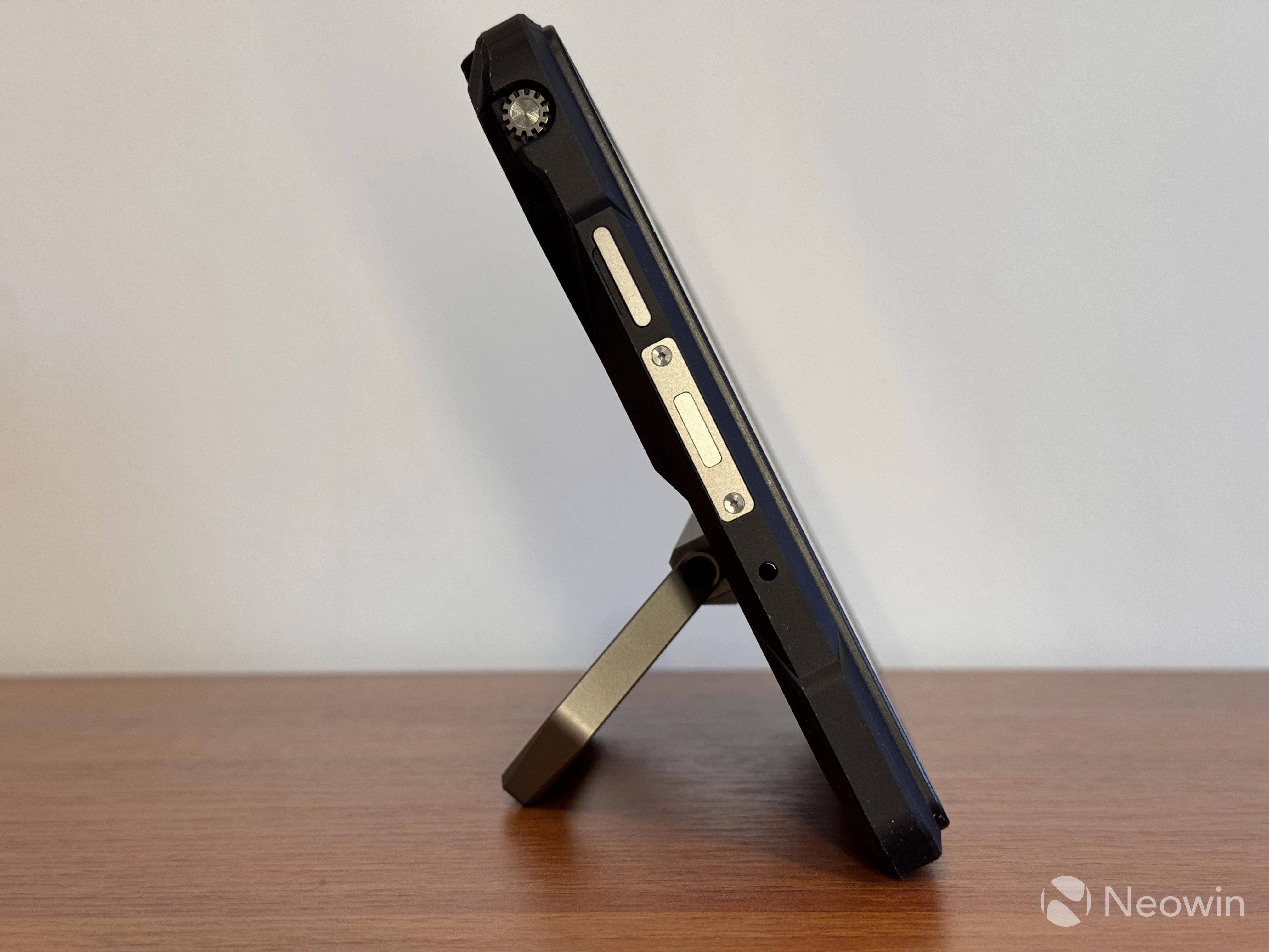

Control elements

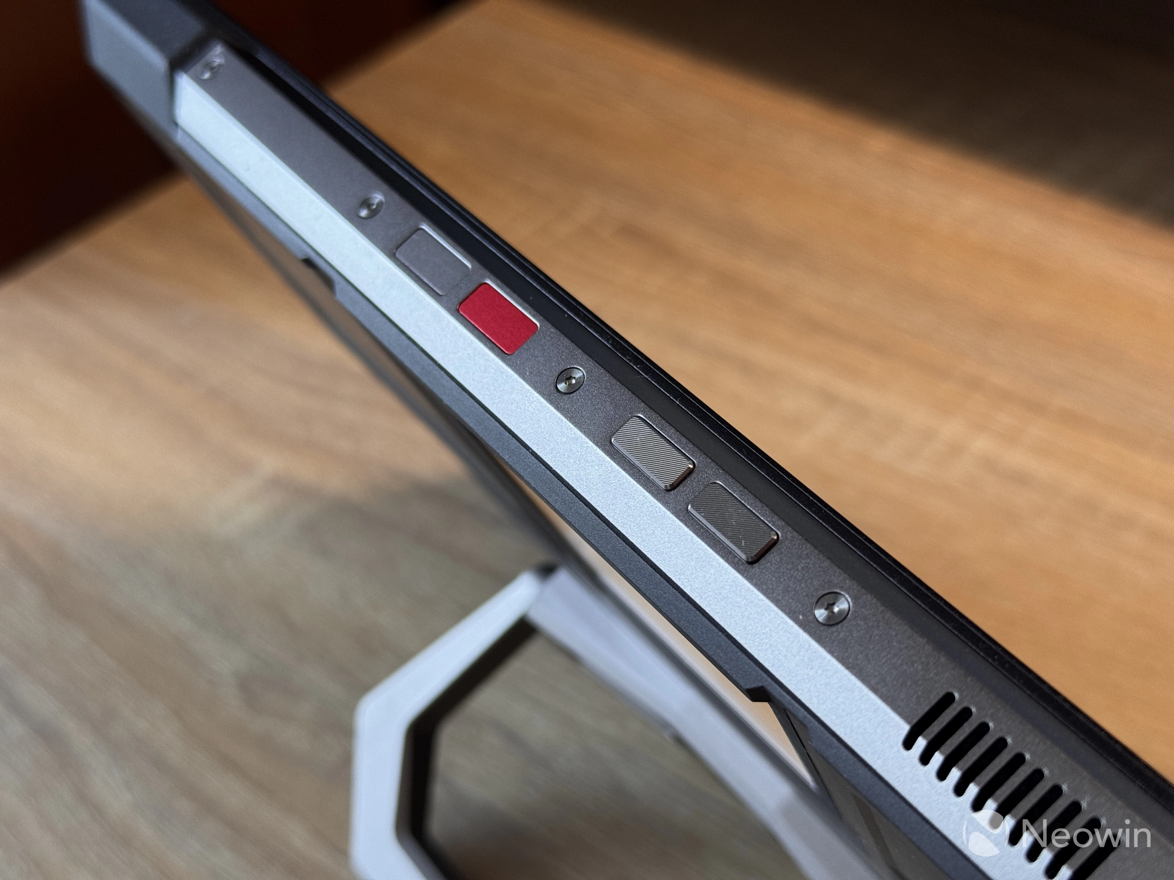

TankPad's control elements are pretty rich. You get your standard power button with a fingerprint reader, volume buttons, and two extra function buttons. The latter two are highly customizable, and you can assign three actions to each (single-press, double-press, and long press). I also like that function keys are recessed so that you won't confuse them with the volume buttons. There was probably no need to paint a single button red, but I like it—it adds extra character. In addition to buttons, one of the longer sides of the tablet features the DLP projector and air vents for cooling.

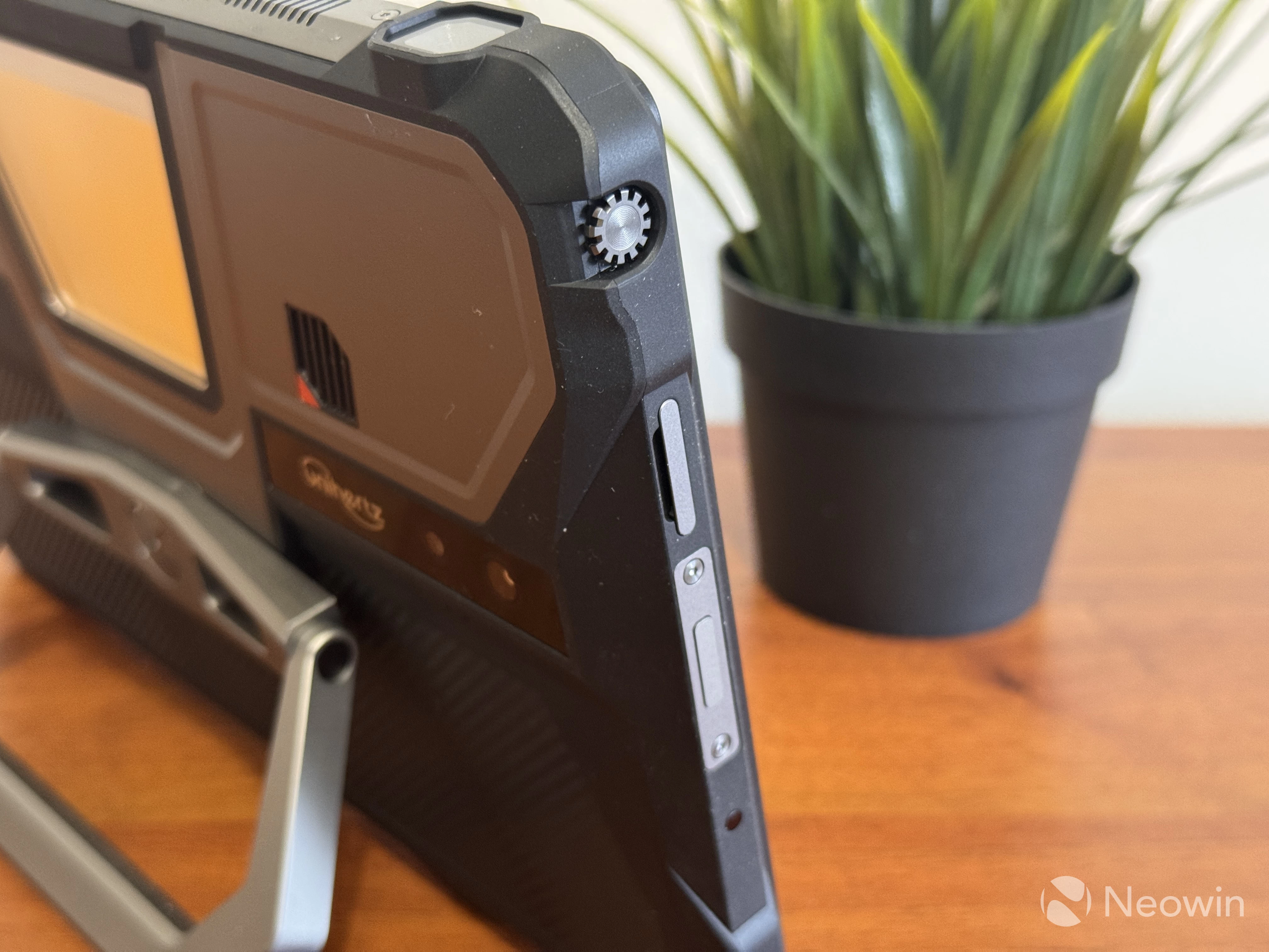

The power button is mounted in the middle of one of the short sides. Like other buttons, it has a good click but is a bit wobbly. Also, the fingerprint reader is not very good—disappointingly, it is way too inaccurate and makes way too many errors. Next to the power button, you will find the SIM card slot, which accepts two nano SIM cards and a single microSD. The slot has a rubber gasket to prevent water ingress.

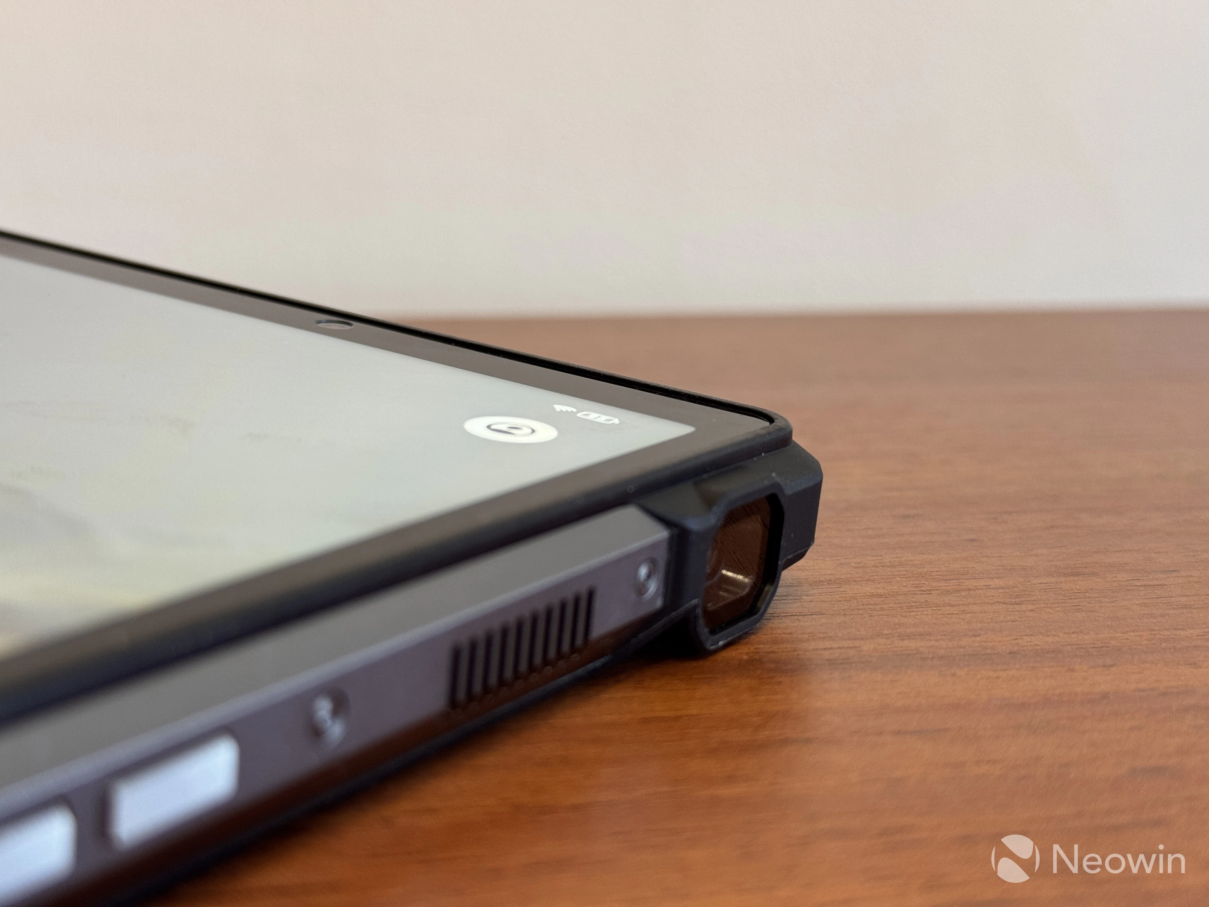

The left side also hosts an IR blaster that can control your appliances and a focus knob for the built-in projector. Ports are located on the other short side, and they are covered with a flap for extra protection.

On the back of the tablet, you will find two stereo speakers mounted on one side. This is a bit disappointing, considering the TankPad is made for use in landscape mode. Also, these speakers are mediocre at best. At this size and thickness, one would expect a much better set of speakers, but no, these are "flat" and they sound disappointingly tiny.

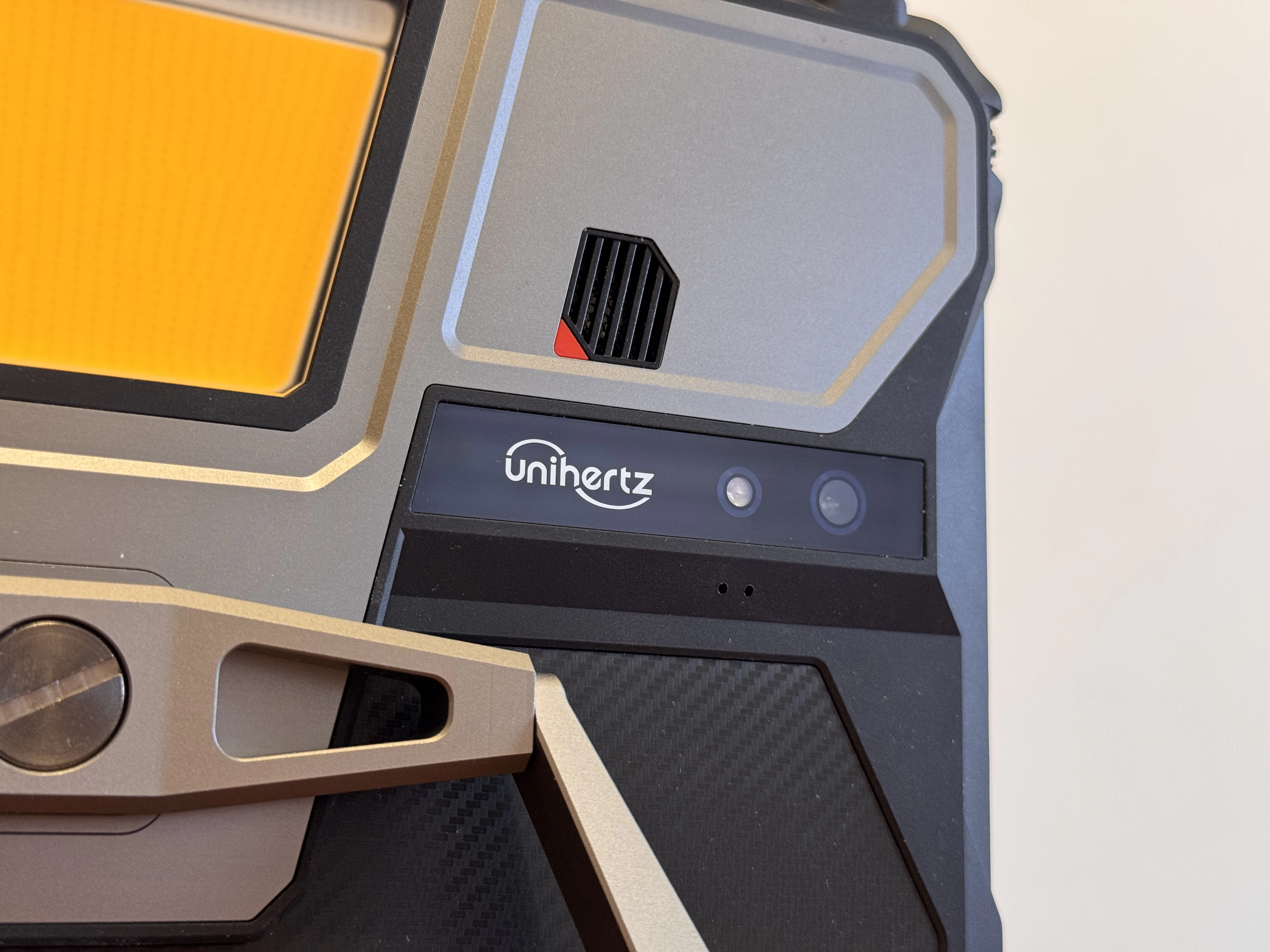

There is also one 50MP "AI" camera with a flashlight, air intake for the projector fan, and a massive 800-lumen camp light, which can also work as a makeshift police light.

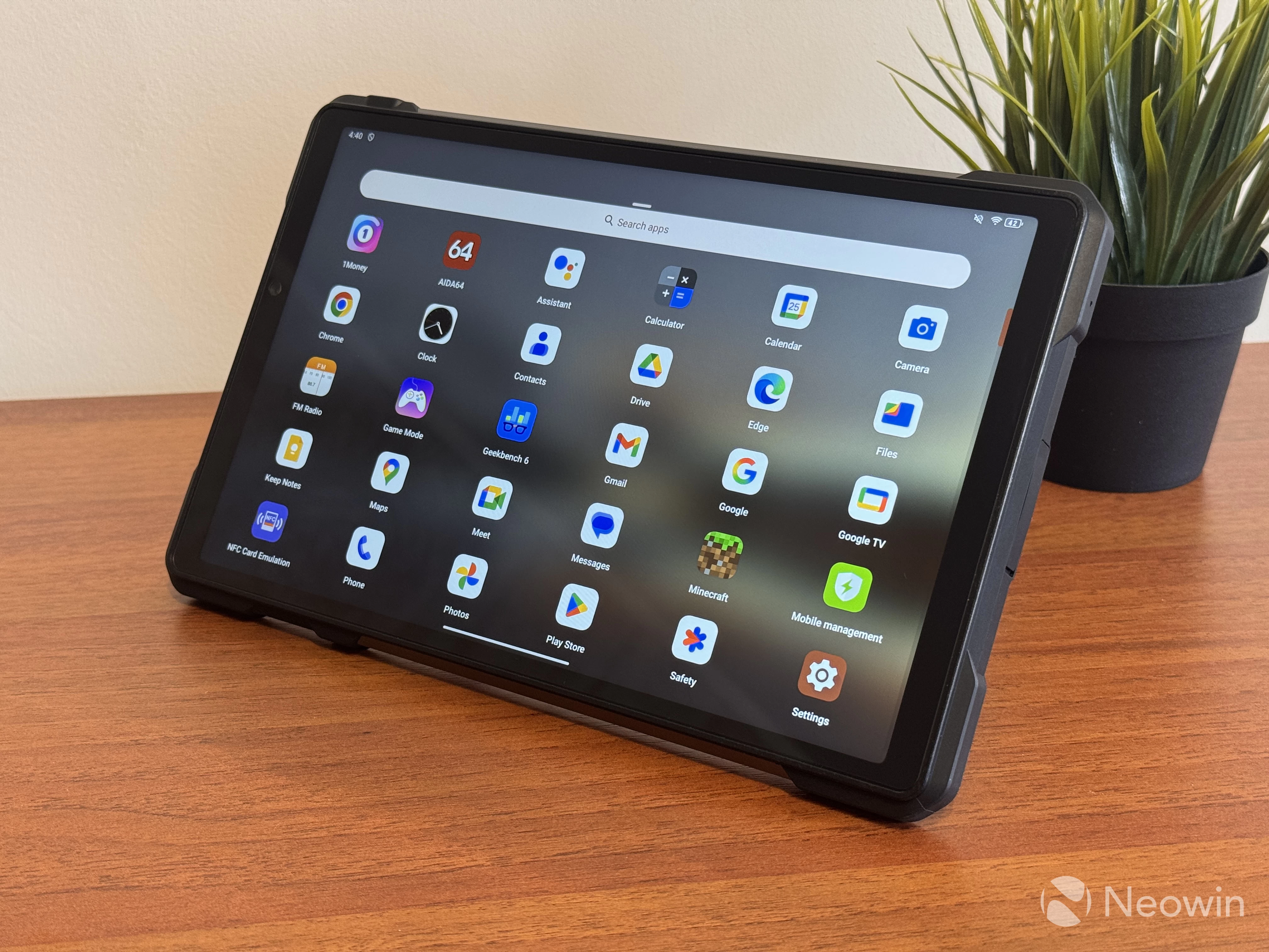

The MediaTek Dimensity 8200 is an eight-core chip that performs pretty well. The operating system is snappy and mostly bloat-free. It feels mostly stockish with only a few changes here and there, with a small sparkle of additional apps like a remote control and a toolbox with stuff like a compass, siren, etc. They work mostly okayish, but translation is very poor, plus the overall UI feels like something from a third-league Android phone from 2015.
The TankPad comes with Android 14 out of the box with September 2024 security updates. I asked 8849 about future updates, and I will update the review once I know more. Still, do not hold your breath for very good support. Having the September 2024 security update as the latest release in July 2025 speaks volumes about software support commitments.
In benchmarks, the TankPad scores pretty well:
  • Geekbench 6: 1,238 single-core, 3,657 multi-core
  • Geekbench AI: 1,132 single precision score, 1,069 half-precision score, 2,191 quantized score
  • AnTuTu Benchmark: 842,746 points
While it is far from modern-day flagship chips, performance is more than enough for this kind of device. It can play games, and it can play modern media. Just set your expectations right and keep in mind that this tablet's main goal is to be rugged and long-lasting in harsh environments. It is not the right choice if you need a bedtime device.

Projector and camp light

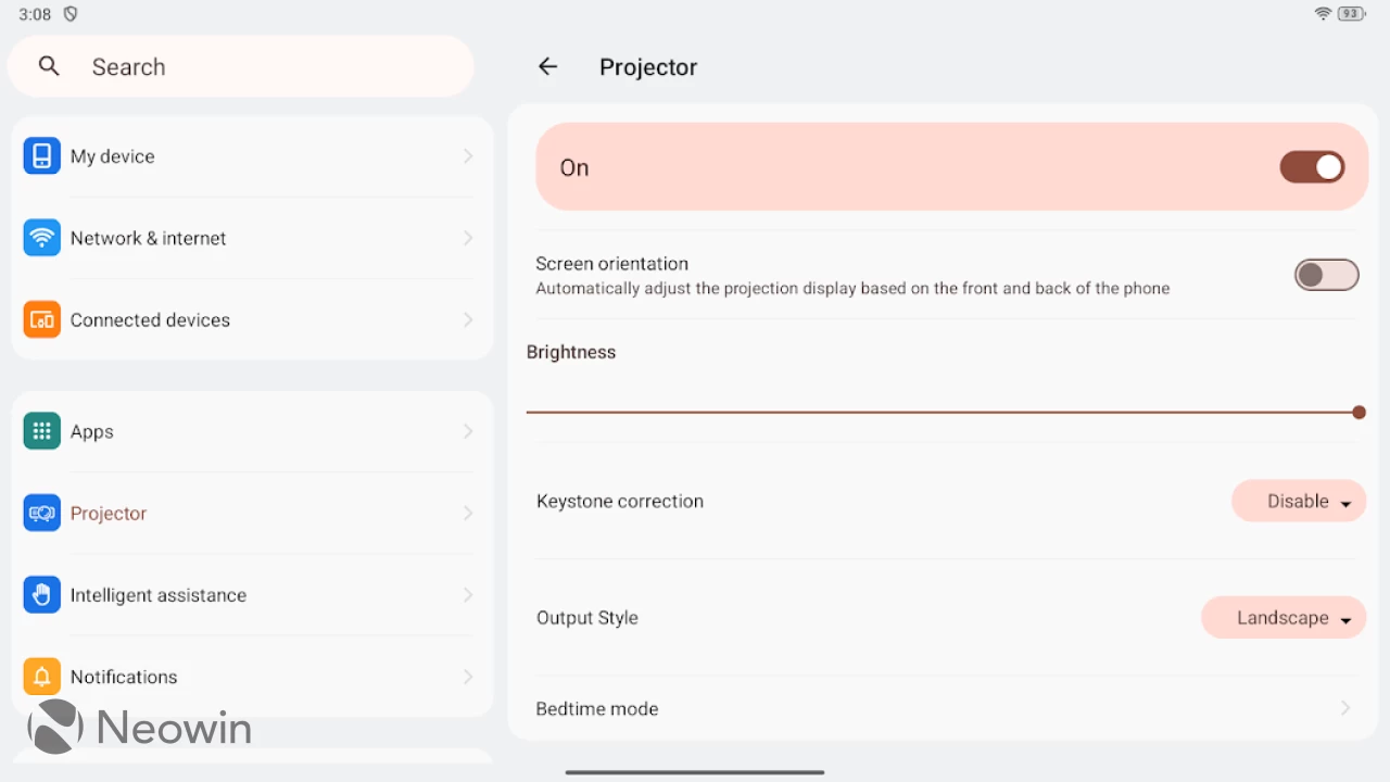

You can launch the projector with a toggle in the control center or a widget (unfortunately, you can't map the projector to one of the function keys, which is a missed opportunity). It takes a few seconds to launch, during which you will be presented with a poorly translated warning screen. In the world of AI-powered translation, it is odd to see such poor translation, especially in English.
The projector operates at 100 lumens, so make sure you are in a dark environment if you want to get good contrast and colors. You can adjust focus with a knob, and it works as expected. The tablet can automatically adjust the keystone. It works well, and I only spotted a few missteps when the tablet could not properly adjust the image to the projection surface. Cannot say it is a big problem, considering that you have a built-in kickstand, which lets you set the tablet just right for good projection.

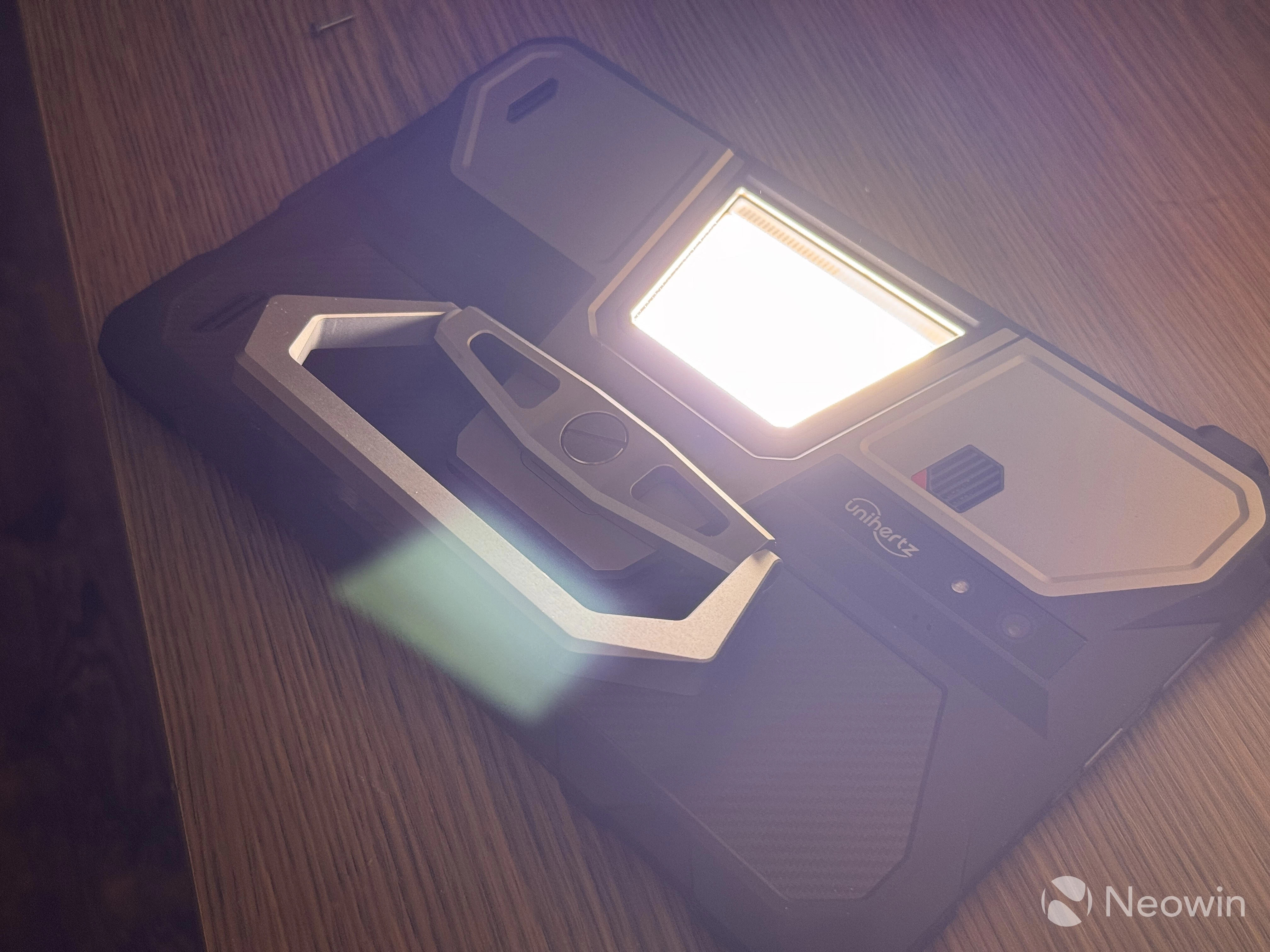

The camp light is cool and useful. It emits a very bright and warm light (800 lumens), plus you have two extra blue and red LEDs that can simulate police lights. These are also insanely bright, and in a dark environment, they look pretty convincing. I am not sure why you need them (scare away a bear in a forest?), but they are here. Besides, you can pair those lights with a rather rich set of various sirens and probably get an epileptic seizure. The app warned me not to "irradiate my eyes" with the camp light, and I was foolish enough not to listen. Do not repeat my mistake, and do not stare into it.
