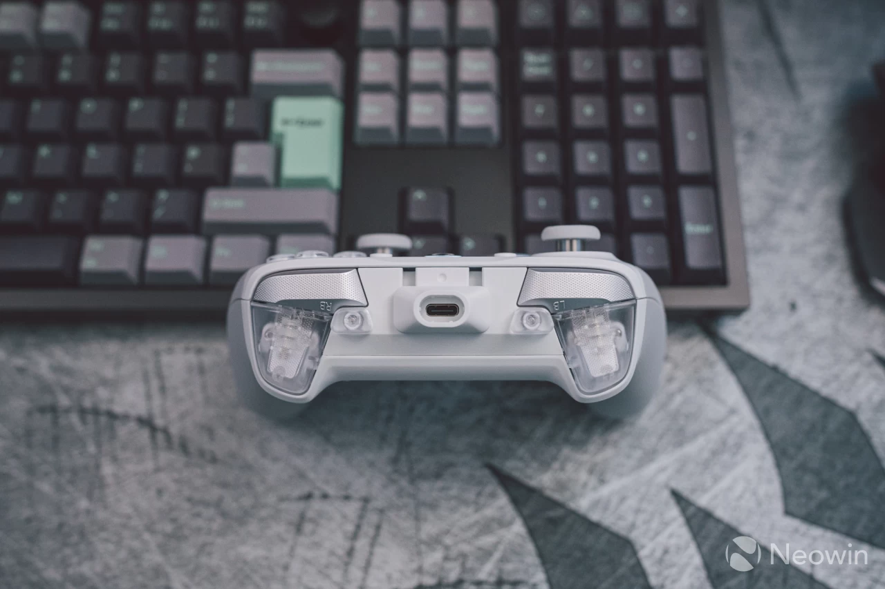

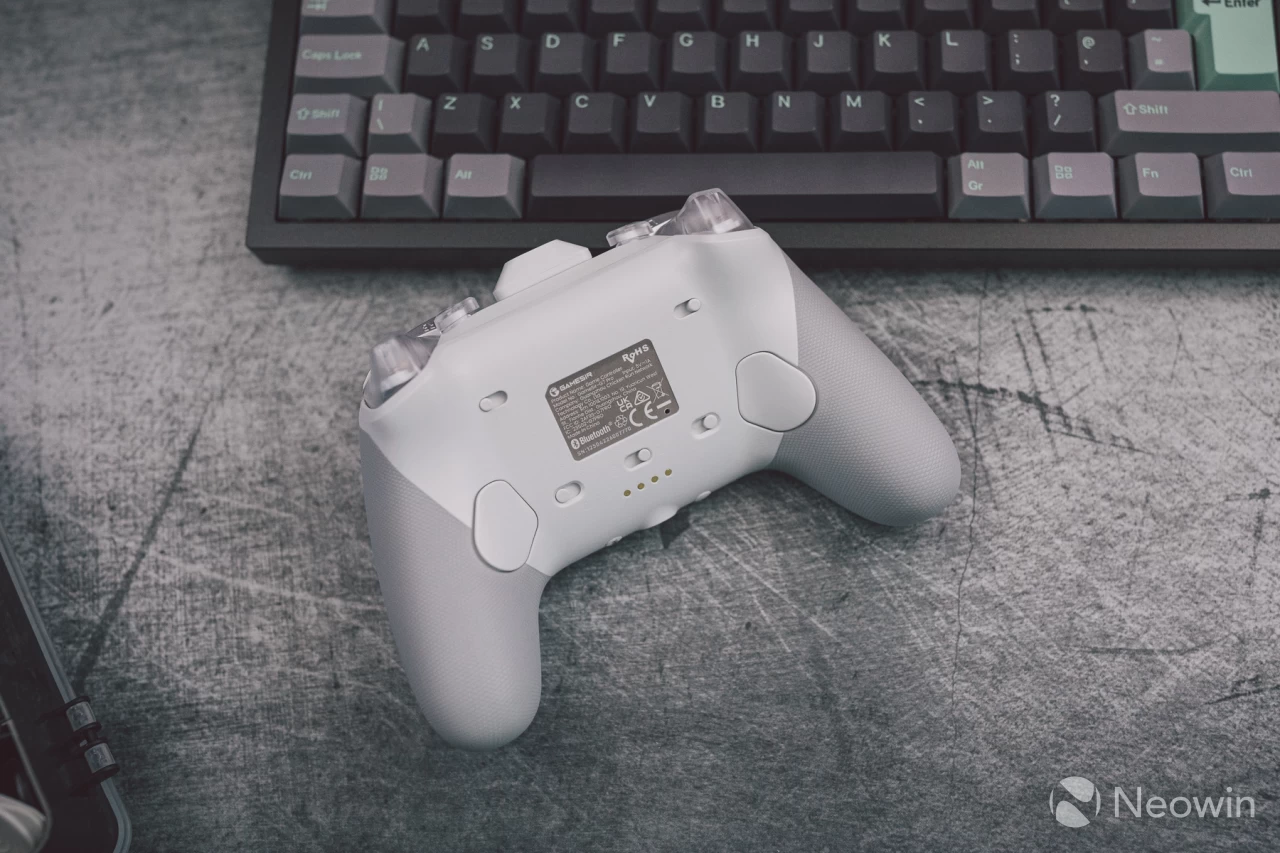

Fit and finish

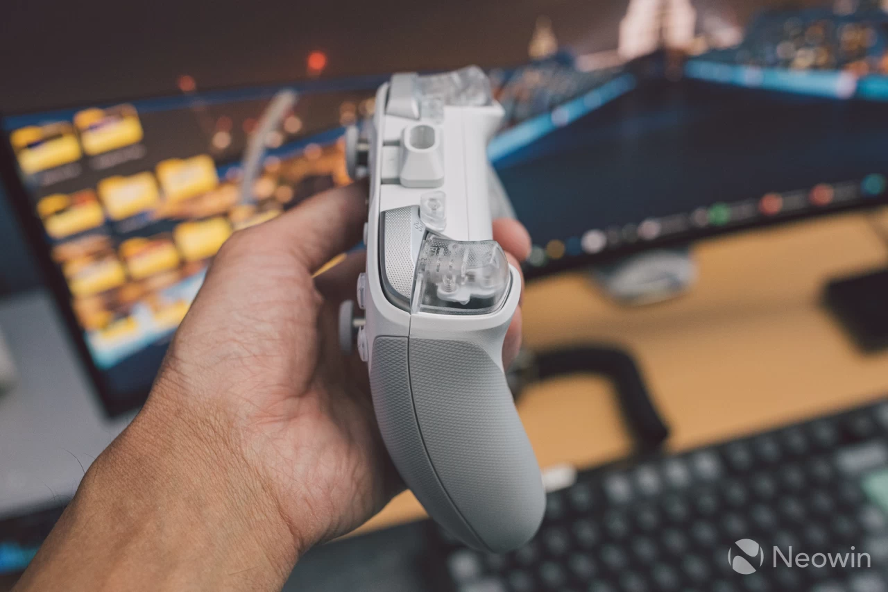

With the inclusion of rubberised underside grips, the G7 Pro, to me, now feels nicer in the hands than the Tarantula Pro, which until now was my go-to controller. I had the Cyclone 2 as well, but a few things bugged me about it, with the d-pad being the chief culprit.
Not so here, for the d-pad on the G7 Pro, even the circular cap, feels excellent. There is some minor sideways play, but no pre-travel pressing down, so the Kailh mechanical switches sound and feel very responsive.

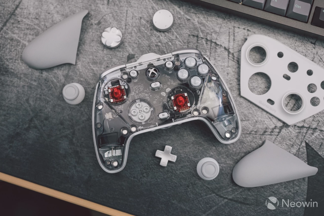

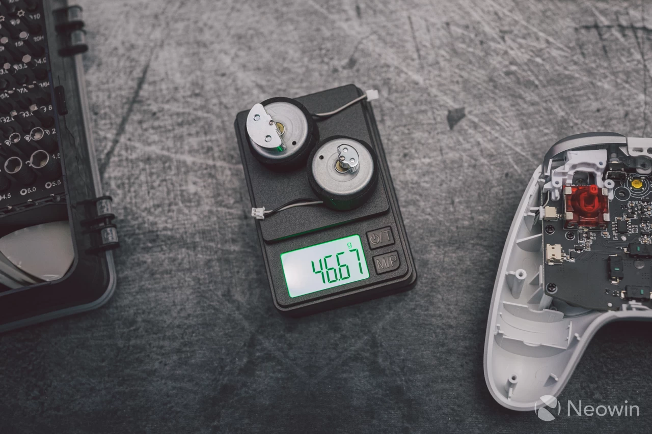

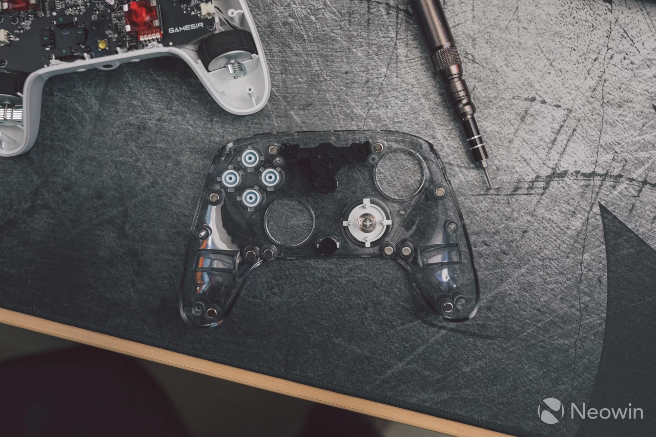

I did a teardown as a YouTube comment asked if the controller can be used with the vibration motors removed in order to save weight. The answer? Yes, but the weight saving is not huge, only 46 grams are shaved off by removing both of the main grip vibration motors.
The teardown did offer an ideal chance to see the black PCB and supporting components, though. For those interested, a T6 torx driver and a plastic pry tool to lever off the clear housing on top are all that's needed.

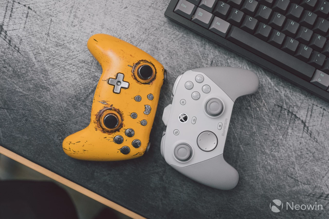

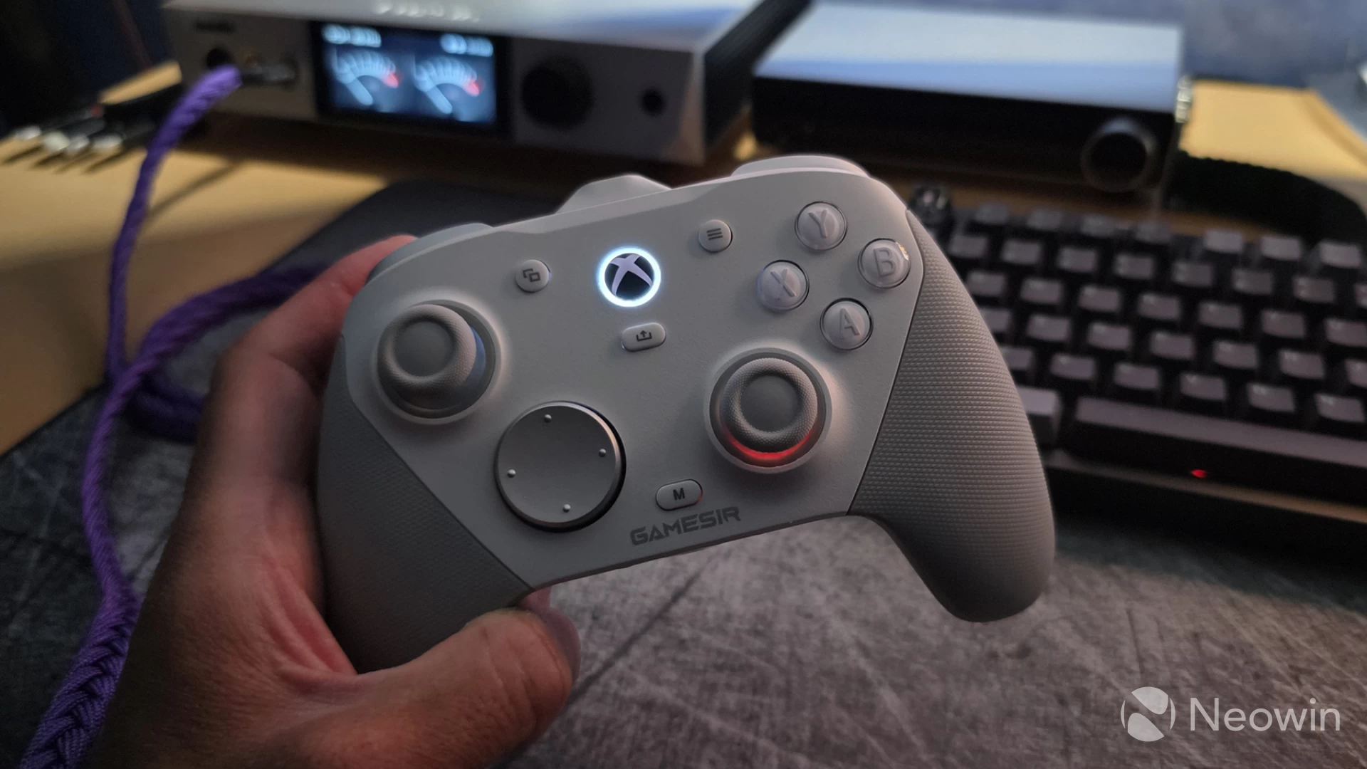

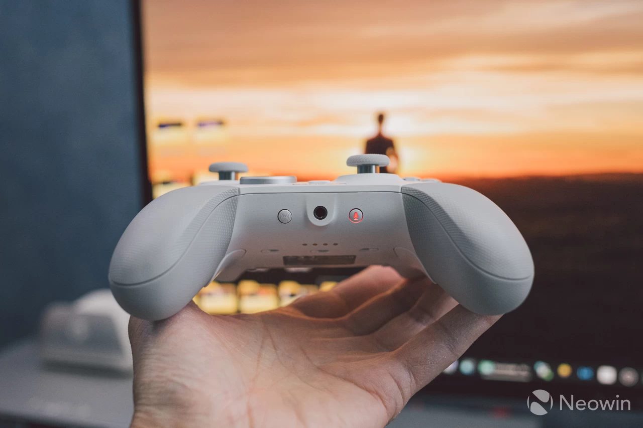

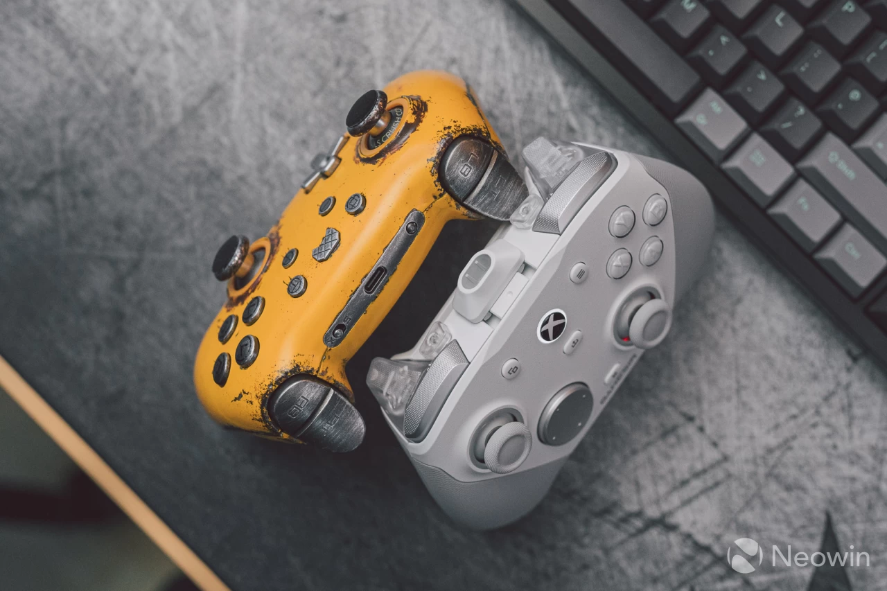

Of course, my other favourite Xbox layout controller, the PB Tails Crush Defender, has an all- metal face plate and sticks, so the G7 Pro can't quite match that, but it makes up for it by having a lot more features and full customisation via the GameSir Nexus software, which I will cover shortly.
A small nitpick is that the microphone mute LED leaks through the right joystick, which may or may not be an annoyance for some.
Gamesir G7 Pro
Other than that, the G7 Pro is a fantastic feeling controller in the hands, I find it more comfortable than the Cyclone 2, and whilst it's not as curvy as the Defender, it is considerably lighter and with rubberised lower grips.

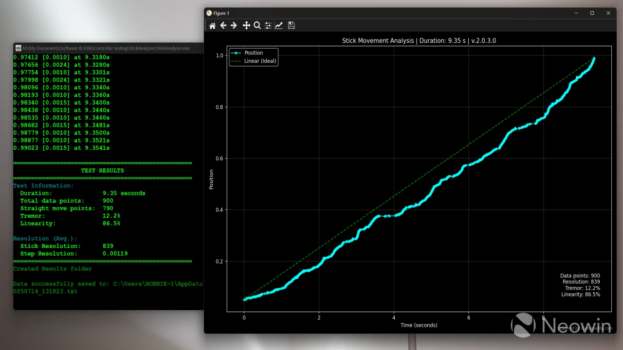

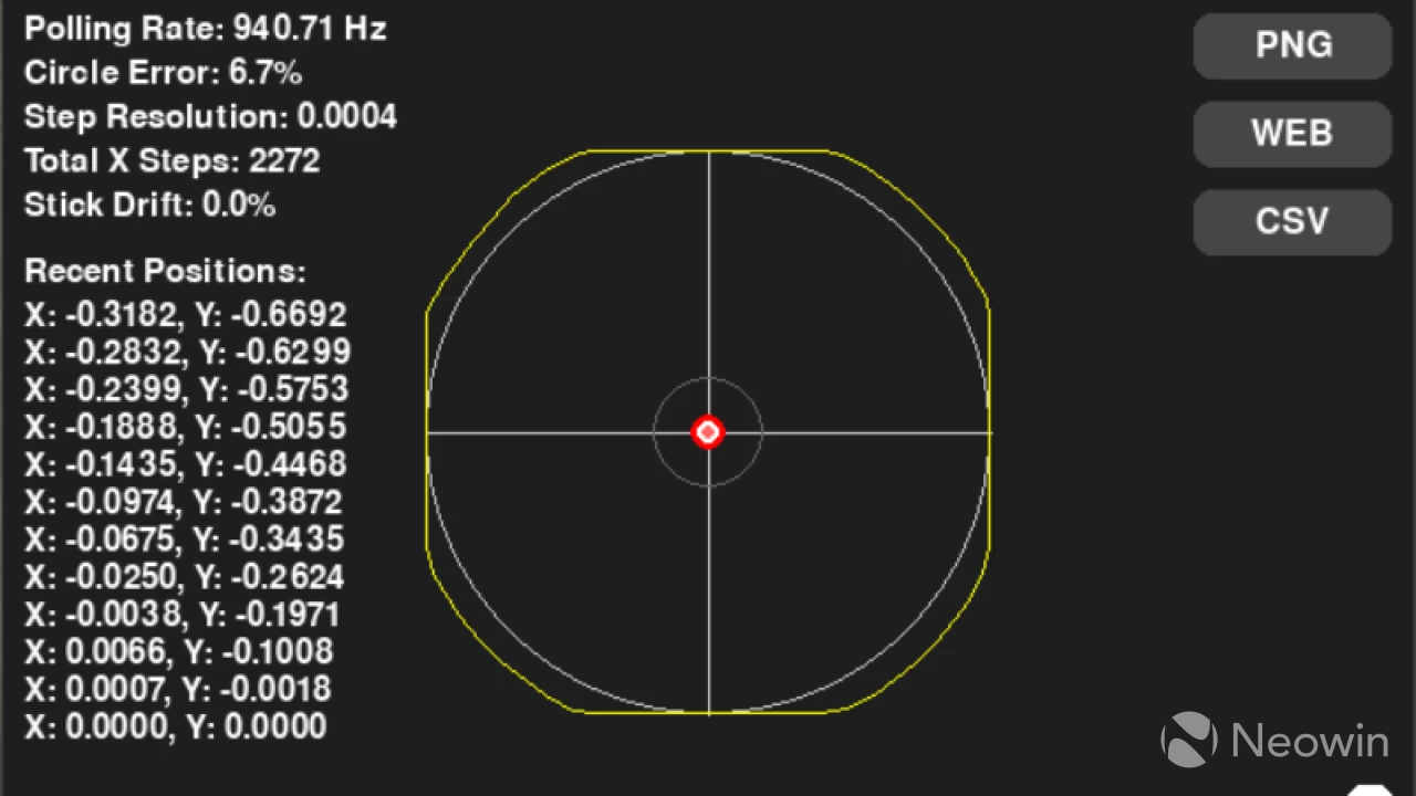

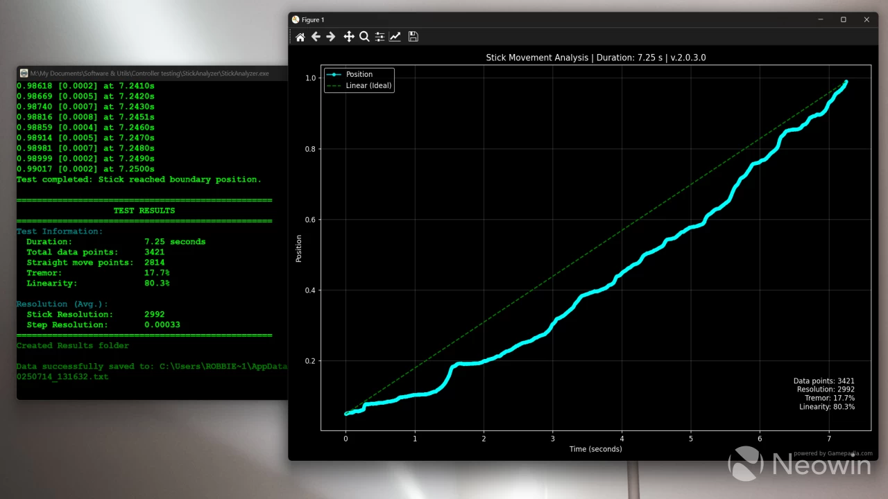

Toolset measurements were also done, for these I used Stick Analyzer, Polling, Joystick Tester and MouseTester (for gyro testing mouse look).
Stick Analyzer shows excellent movement processing, accurately reading my movement tremors and not filtering them out. The registered resolution is not quite 4096 as advertised, but rarely is this the case; the key point is that it's ~3000, which means it is set up to be up to 4096. If it were ~2000, then this would be an issue.
GameSir G7 Pro GameSir Tarantula Pro
GameSir G7 Pro
GameSir G7 Pro
By comparison. the Tarantula Pro is unable to get anywhere near the G7's resolving power.
Joystick Tester shows excellent raw circularity, among the lowest I've seen yet at 6.7%. A figure of 9-11% is perfectly normal here, so the G7 Pro is excelling here:
GameSir G7 Pro

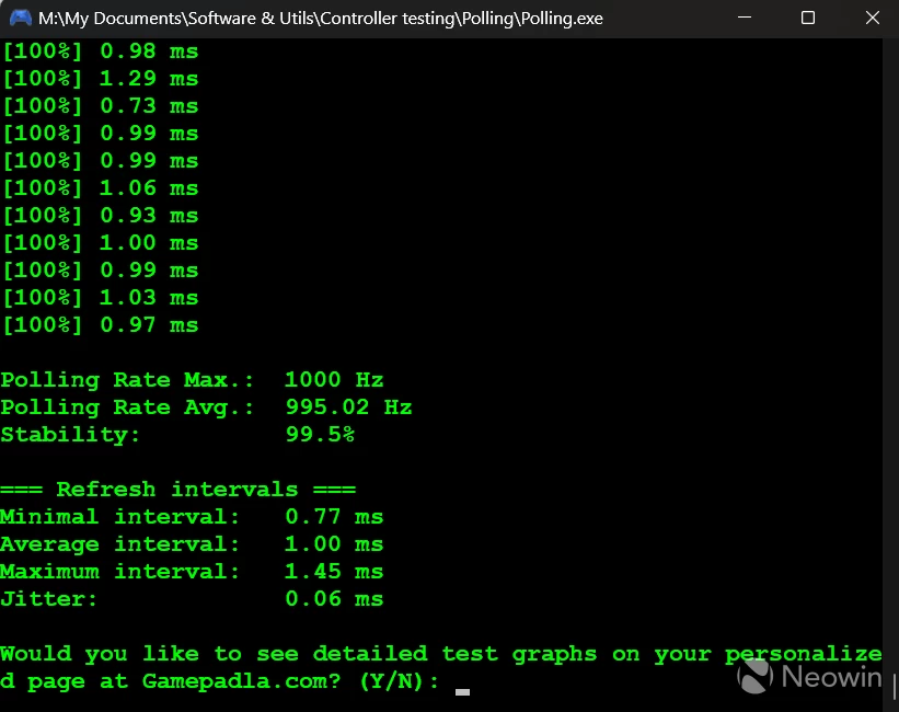

In Polling, the trend continues, and stability registered at 99% is essentially flawless. The Tarantula Pro managed just over 90% here, with a 2ms maximum latency interval:

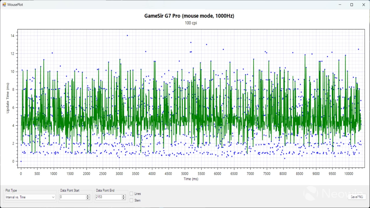

And lastly, motion control. For this test I set the gyros to emulate the mouse, and set Nexus to the maximum 100 DPI for motion control. The results were simply average, keeping in mind that it's only 100 DPI, too:
GameSir G7 Pro
This graph may initially seem complex, but it's quite easy; it displays the latency between the gyros (mouse, in this case) being polled and the PC receiving an input; lower and more consistent times are better, so we are seeing an average latency of 4ms, with spikes averaging 10ms.
These are not competitive results, so unless you absolutely need mouse look, then I would suggest leaving motion control set to one of the sticks instead, as you retain full resolution and low latency this way. Also set one of the additional bumper buttons to act as the activation button for motion control when it is held down Motion control is active, meaning I can use motion-look in any game at any time simply by holding that button and moving the G7 Pro around.

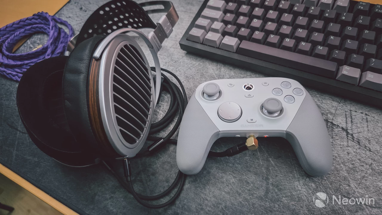

As a wireless/wired headphones amp/DAC
Now, here is something you probably never thought you would see in a controller review, but let me just say that the G7 Pro works really well as a DAC/headphones amp.
I actually tried this out just out of sheer curiosity, only to walk away amazed at what I was hearing. As a bit of an audio geek, I can't stand an audible noise floor or distortion, so when I plugged in my HE1000se headphones and heard zero noise, floor hiss, and distortion with the volume at max, I was taken aback.
A games controller having the soundstage and dynamic range to deliver acceptable audiophile-level sound through high-end headphones... what a time to be alive.
GameSir G7 Pro
Okay, the volume loudness is not as high as what would be possible from a dedicated headphones amp driving headphones like these, but it was loud enough to still be able to enjoy music.
The only drawback is that if you are playing games, then there is audio latency when doing this over the 2.4GHz dongle. To mitigate the latency, you would need to be gaming using a USB cable to the PC.
