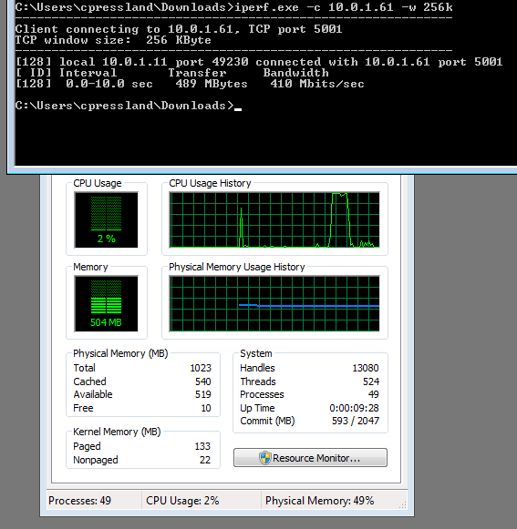

Windows 7 Virtual Machine - iperf -s -w 256k
Galactica Physical Machine - iperf -c 10.0.1.11 -w 256k
Speed = Approx 400Mbits/sec
CPU Use = 100% on Windows 7 VM during Transfer.
pfSesne VM - same situation!!!!
So - why is Budman's performance better in this instance? What would cause a VM to use 100% CPU time for a basic network transfer?

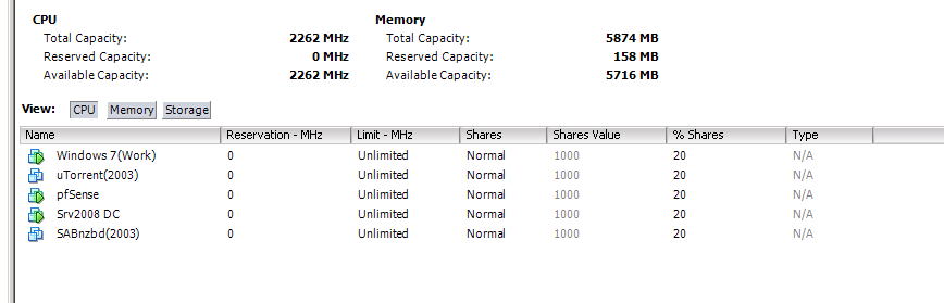

Do you have your VM's limited to what they can use?
This could be the reason your seeing the limit.

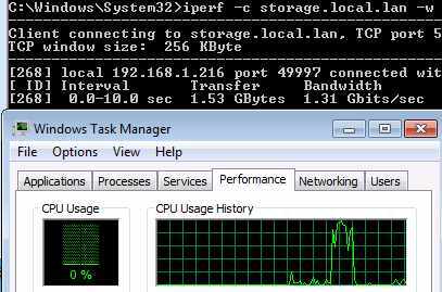

Let me run another iperf and check what my vms cpu does and what it maxes out at, etc.

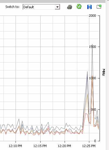

Ok -- here is client, server and host while doing iperf and getting 1.3+Gbps
client
server
Host
And remember we went over this before, my vms only have 1 cpu assigned to them. and here you can see not restricting their usage on the host
What does your cpu look like -- are you actually hitting 100% and just staying there.. That would explain why your seeing a limit on the speed.

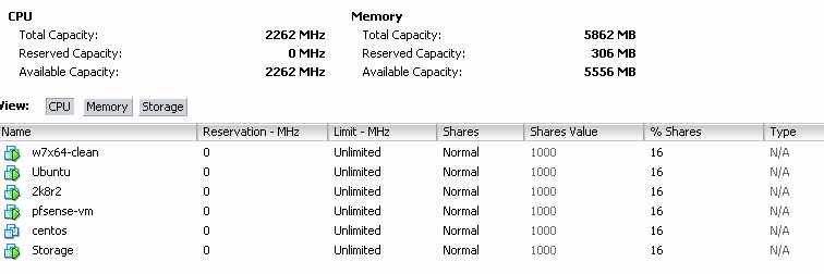

Can you SSH into your pfSense VM and run top and iperf server on it and let me know what CPU% you get during the transfer. If you get similar issues over pfSense to what I get on Winodws that further helps diagnose this.
Additionally how exactly do you have CPU setup in VM settings?

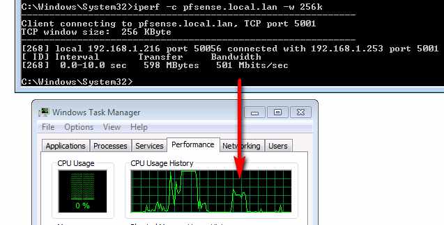

here is my win7 client to pfsense running iperf server
But I have never seen great performance to and from windows with pfsense, but as you see my windows client is only see about 50% cpu and 500Mbps -- which is much better than yours????
