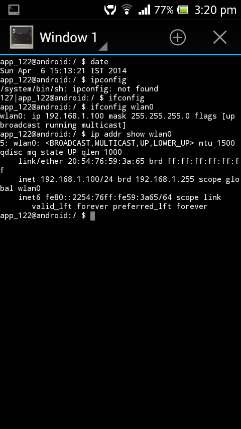

More or less; Your Android seems to have its wlan0 interface (wifi) with a IP address that is in use by your router!
Before anything else, I wanna fully confirm this so on your Android (which is connected to the wifi) go ahead and open terminal emulator and type:
ip addr show wlan0
This will confirm.

Guys sorry for late reply.
Here is the screenshot of ip addr show wlan0.
If I'm reading everything correctly, your phone has the same IP address as your laptop. This is a problem. Are you using DHCP on your router and/or do you have any IP addresses manually entered into either your laptop or phone?

Try opening the command prompt on your PC and type the following:
ipconfig /release
ipconfig /renew
That should tell your PC to find a new IP from your router that is not in use by any other devices.
As a test you could try shutting that PC off and testing your phone to see if the issues go away. If they both have 192.168.1.100 you will have problems.
I tried using only my phone connected to that network,but still no luck. :(
