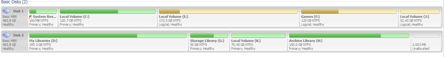

Here's a screenshot:
What I want to do is:
DISK 1 (SSD):
Add Local Volume J to Local Volume C.
Split Local Volume E down to 120Gb, add the remaining to Local Volume C.
DISK 2 (HDD):
Add Local Volume K to My Libraries D.
Add Unallocated 2Gb to My Libraries D.
However Acronis won't allow me to merge those two together.
Read about gParted and managed to boot into that but moving the partition wasn't as easy as I thought.
I do have a spare 1TB drive so for the latter HDD, I could copy all the data from G and H to it, then merge the whole lot together in one partition.  Then split it into the three but it's a lot of work waiting for stuff to copy.
I guess the same could be done with the SSD as when Windows 10 comes out, I won't have anything on the E or F drives.
But then again, I am learning new things with new programs.
Why is it Windows won't allow you to merge to the left?

That's what I had Gparted for so it was outside of the Windows solution.
However I now  understand what the internet is saying on how you can do it using Acronis (or others).
Basically, you have to shrink the partition and state you don't want any unallocated space after it.  Then it'll move it over to the end of the hard drive.  Gparted probably can do this but it's a little harder to understand from the program that runs.
The only data I need is on the My Libraries, which shouldn't be touched as I'll only be adding space to it and the C:\ drive, which again shouldn't be touched as it'll only have more space added to it.
The G and H drives I'll back up onto the external anyway just in case and I'll take a backup of the Libraries as it'll then be done for the transition to Win 10.
I didn't really understand about the dragging the partitions into the allocated space.

It's not the size that's the problem.
I don't need to spend money on bigger hard drives as I have an external 1Tb drive hanging around doing nothing but I am happy with the 1Tb I already have.
The problem is getting what was unallocated space on the very right hand side of the picture to merge with disk K, then merge all of that with D to make D bigger.
Take a look at my second post again.
The second drive... the unallocated space cannot be merged with the K drive as the H drive is in the way.
The K drive cannot be merged with the D drive because G is in the way.
Windows doesn't allow you to merge unallocated spaces without reallocating the whole drive, so the Storage (G) and Archive (H) have had to be extended, then shrunk like a caterpillar into the empty spaces so I could combine D with the empty space.

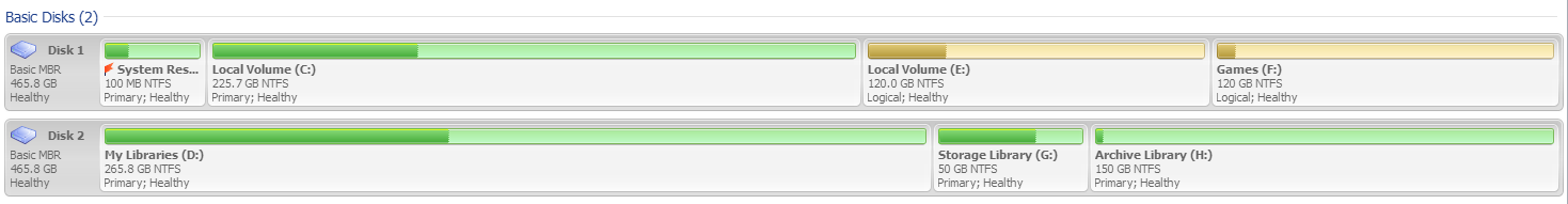

However, after all the moving and merging, I now have what I set out to have:
This means I can install most programs on the Windows © drive and have more space for Documents on the D drive.
