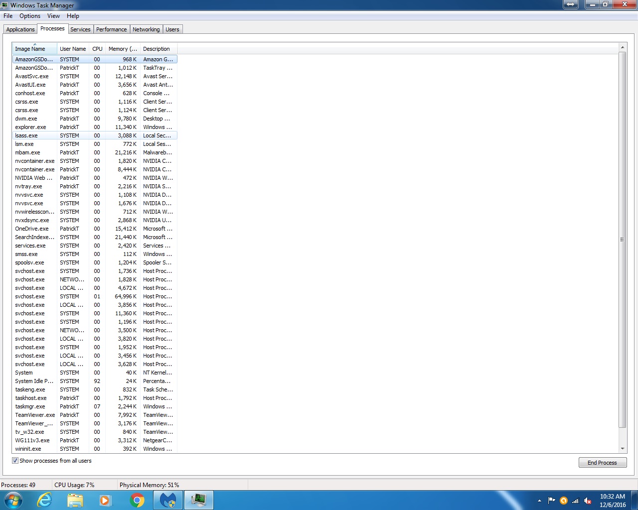

If you look in Task Manager do you see any particular process maxing out the CPU, Memory or Disk?
Slowness was there, but wasn't as bad as it is now, takes like 1-2 minutes at least just to open Malwarebytes,  did do clean install of Avast beta on November 3rd, but I figured well would run about same as old version, but seems not to be at this point, of course that system is old, so might just be it's always been that slow and i'm more used to my 8 Core system, than using the Windows 7 Atom PC.

Ahh, that's not as high as I was thinking. There's a stinking bug with Windows 7 that sends Windows Update into a meltdown and massively slows the machine down, but it would be a single svchost.exe that is using 200+MB of RAM.
