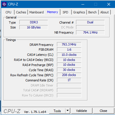

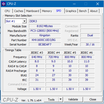

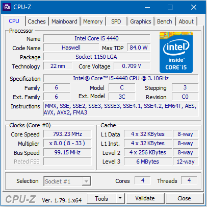

Steven P. Administrators Posted June 14, 2017 Administrators Share Posted June 14, 2017 I have the Kingston HyperX Fury 16 GB DIMM DDR3-1600 2x8GB my Asus H87-Plus BIOS says they are rated at 1600Mhz but look at what CPU-Z says? Link to comment Share on other sites More sharing options...

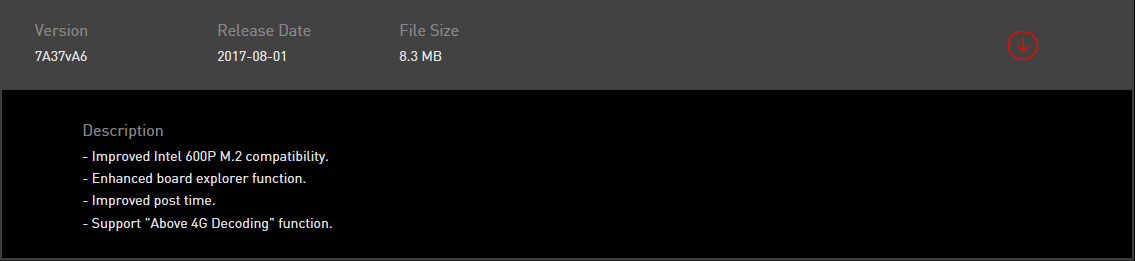

Paradoxxical Posted August 11, 2017 Share Posted August 11, 2017 (edited) I found this, I think a bios update would help now, I know this is for the Mortar version, but check for the tomahawk one. Link to comment Share on other sites More sharing options...
