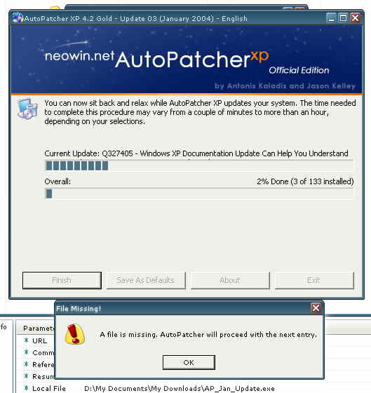

See the errors that are attached to this post and the following post. They happen in sequence, with the second one happening immediately after the first.
I ran Jan Update by installing the original AutoPatcherXP and installing the Jan update over it using the installer. I don't need to install all the updates up to Jan, do I?
