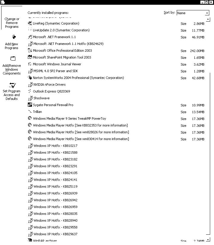

It also bugs me that I don't know how to REALLY check whether my DEC FULL (updated to Jan) actually worked.
Maybe FLish or Raptor could post a screenshot of their ADD/REMOVE programs window so that we could reference what is/should be in there??
