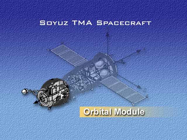

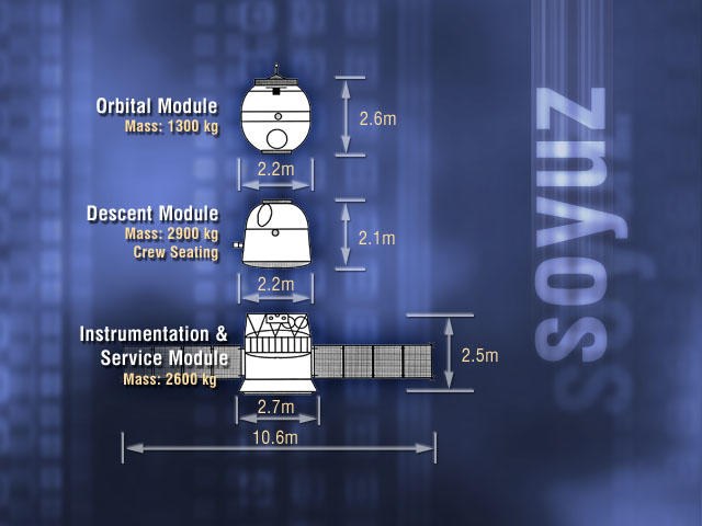

"The Orbital Module is located on top of the two other sections of Soyuz. It is 2.98 meters long and 2.26 meters in diameter. It has a total mass of 1,300 Kilograms and offers a habitable volume of 5m³. During Ascent, the Orbital module is sealed from the Entry Module by closing and latching the inner hatch. Once in Orbit, the crew opens the hatch and can use the BO, as the Orbital Module is also known, as habitable module. It is used to carry cargo and equipment to space and houses equipment required to allow the crew to live in space.
BO contains a toilet and communication equipment. On the top side of the section is the docking assembly of the Spacecraft that features navigation antenna systems and the actual docking port with docking probe and associated lights and sensors. The Docking Interface features the KURS hardware that is used for the automatic rendezvous procedure. Also, the docking interface includes electrical and communications systems connectors for power transfer from ISS and communication relay.
A side hatch on the module allows crews to enter the capsule at the launch pad and during pre-flight operations. The Life Support System can support the crew for 30 person days providing Oxygen Generation and Carbon Dioxide Scrubbing Capabilities. Also, the atmosphere aboard the Soyuz can be topped up with Nitrogen from storage tanks to keep the capsule pressurized."

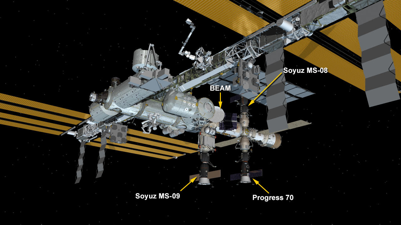

MS-09 can also be sealed from the ISS completely via the hatch.

1) Construction initial planning for an MS is approximately 2 years...These are HSF units, not cargo.
2) The OM and ISM modules are jettisoned prior to re-entry. The crew have suits with consumables.

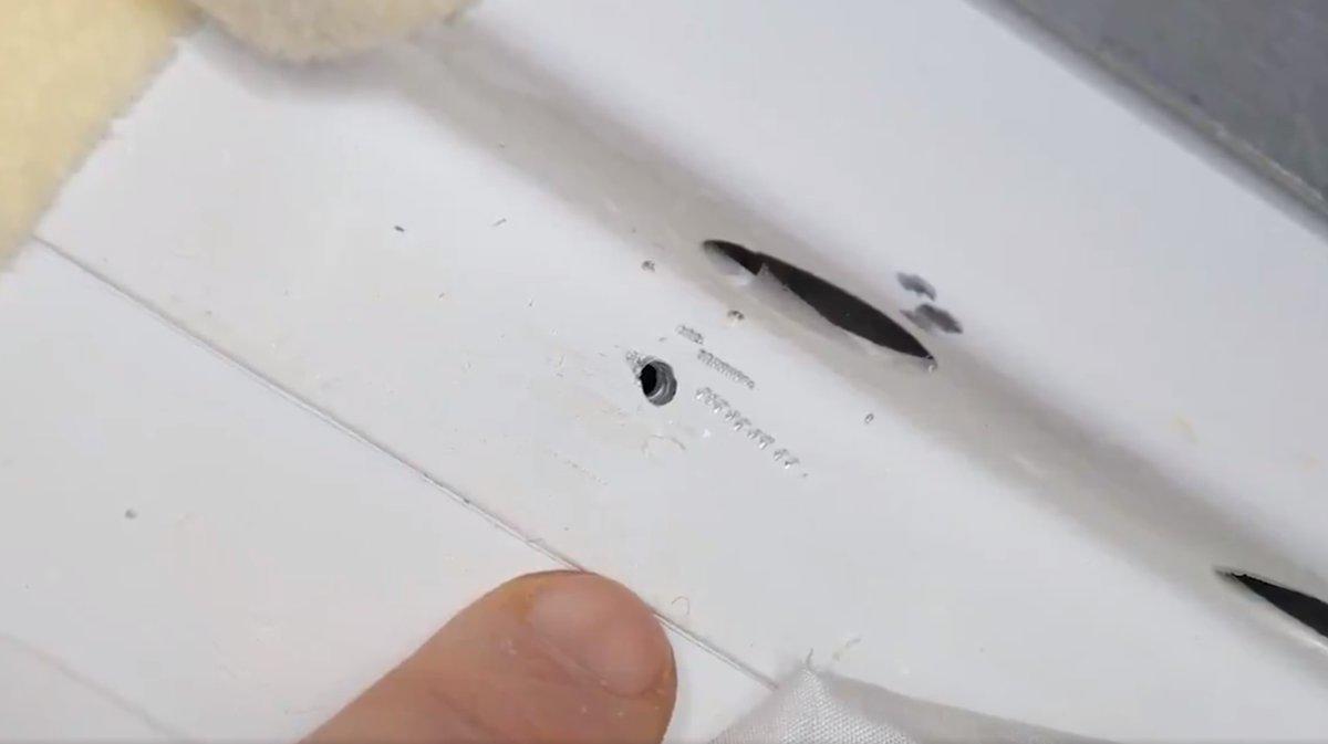

The image of the "area in question" was more than obvious....angled drill entry and a mess of chuck skip marks. As, above, it will probably come down to a newbie, untrained worker or one under the influence. What is really disturbing is that the checks and balances of the process were.....not even present.
Many unverified sources are stating the same but one must wait for the official statement from the partners.

Few extra's for updates...
"The hole has been repaired to the point it's no longer a problem (the crew was never in any risk). However, the implications are obvious. I don't have any new info and NASA is yet to react, but that's where things stand today."  ChrisB NSF....(having posting issues here)
"ISS Leak summary: First thought was MMOD strike. Then NASA released pics. Lots of people: "Hmmm, doesn't look like MMOD". NASA deleted the photos. Top Russian news site RIA NOVOSTI reported - via sources but apparently confirmed by Mr. Rogozin - it was a drill hole." ChrisB NSF

"The reason for the appearance of a hole in the inner case of the domestic compartment of the Soyuz MS-09 ship has been installed on the Earth." He was responsible for negligence, "the source said.
According to another source, the employee, most likely, after he realized the error, sealed the crack with special glue, so it was not detected during the test of the spacecraft on the tightness before launching and did not make itself felt the first two months of the orbital flight.
"However, in the future, the glue dried and was squeezed out, opening the hole," - said the second interlocutor.
