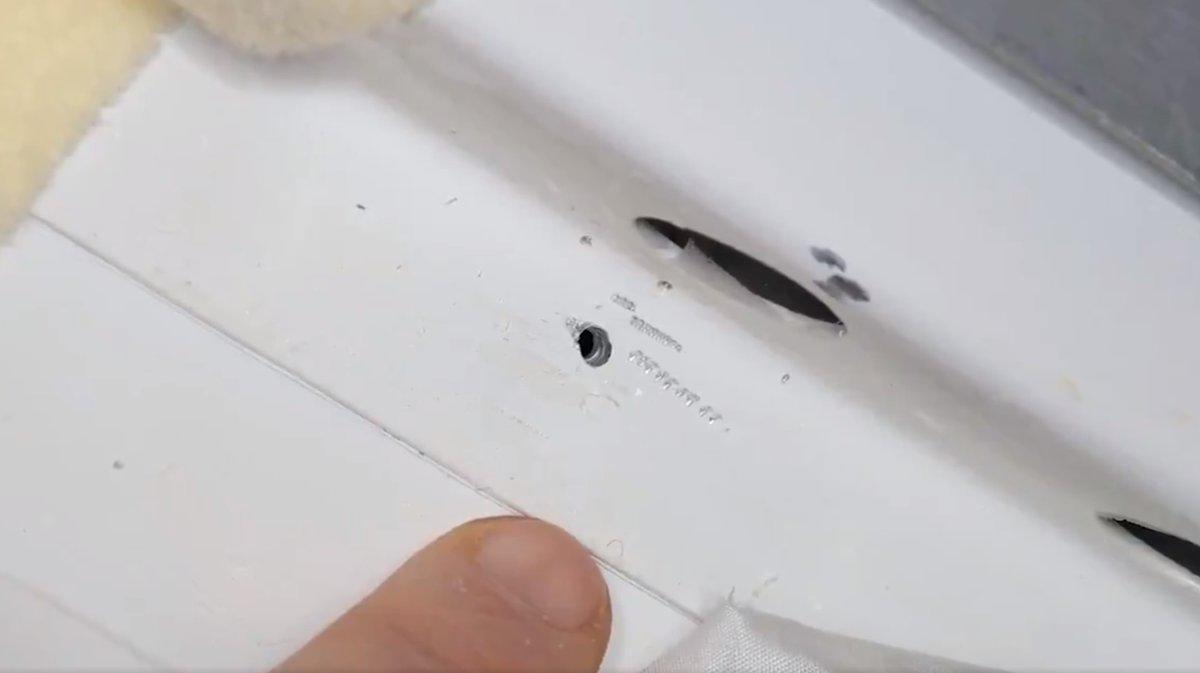

Interesting points...
1)  If the plug is found, the composition will show that the material is probably not available on ISS.
2) The ISS has atmospheric composition sensors which would have picked up the outgassing of the plug material during the curing process.
3) The location is difficult to reach and is covered by "cloth" material.
4) Drilling in orbit is not taken lightly due to the particles getting everywhere unless somehow contained...aluminium in the case (white surface ).
5) Hanlons Razor...."Never attribute to malice that which is adequately explained by stupidity."  Which begs the next question...how did this individual know what material to use, did they ask someone of knowledge...hence more than one involved.
6) This glue/sealant survived the stress of launch and 3 months in orbit.......I need to know the brand....take my money, I want a tube!

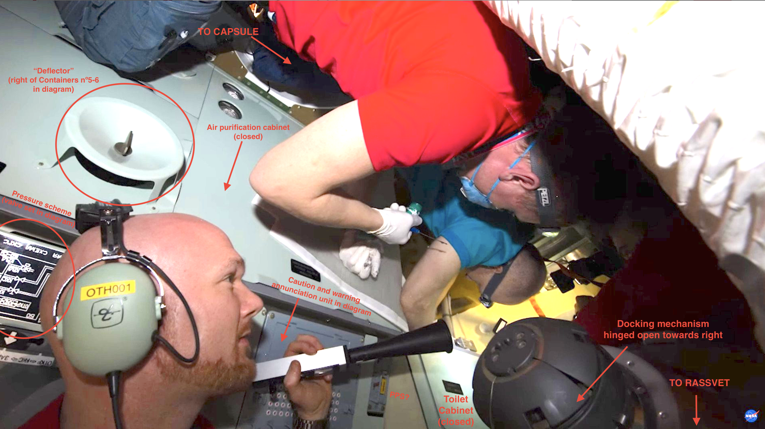

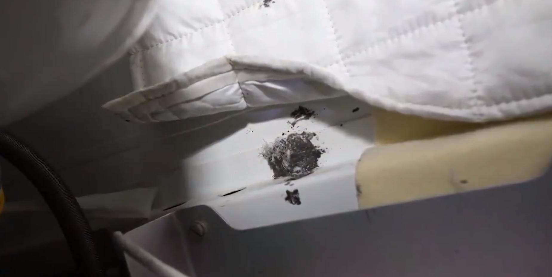

Just a few bits of data....
Pre repair area  (rotate 180 to match with repaired image)
Post repair area

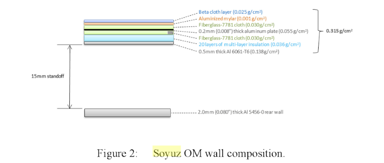

OM wall construction

Sergey Prokopyev did a quick video to show the tools for the repair and the area inside the OM. This is a great video, is in Russian but a link is provided with a translation.
(posting issues)
https://twitter.com/roscosmos/status/1039130465251336192   video is 1:51 min.
https://twitter.com/katlinegrey/status/1039140042554454016 translation to print.
Quote

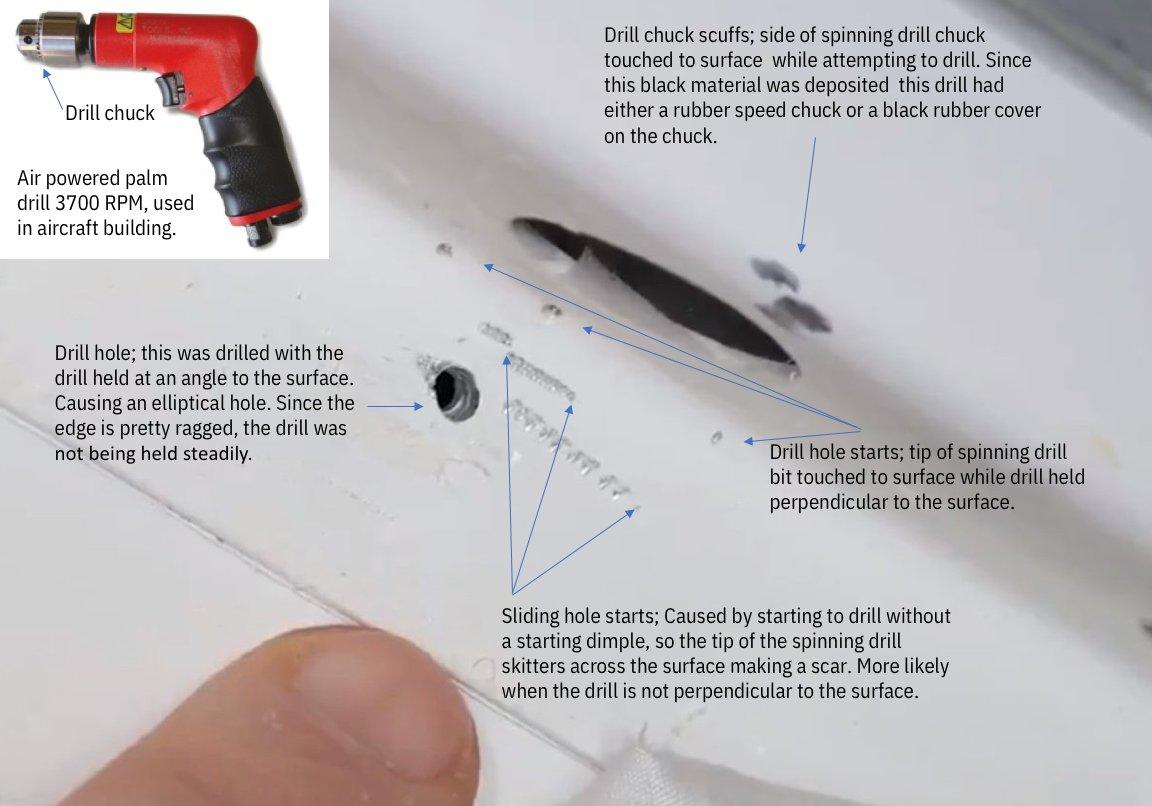

The #ISS "MMOD" hole from the point of view of an @EAA aircraft builder I looked at it from my mistakes while building. This is a pretty hurried or minimally controlled attempt to drill. (When I screwed up this bad I scrapped that part for safety.)
https://twitter.com/InventorCat/status/1039170388922691584
