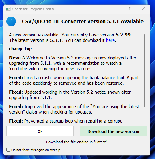

v5.3.1
January 16th 2026 Latest

  • New: The Update Available label now displays the new version number.

On 21/05/2025 at 02:35, mentalindustries said:
Just posting to say just found this app, and looking like it's going to have great potential!
Thanks so much for creating it.
Any ideas on best way to get notifications of a new release?
This new version 5.3.1 includes a popup notification when a new release is available. It also lets you download the new release to the folder the current one is in, simply by clicking download.image.png.e4ba77862ffafaaff79e74c98e80f3a1.png
