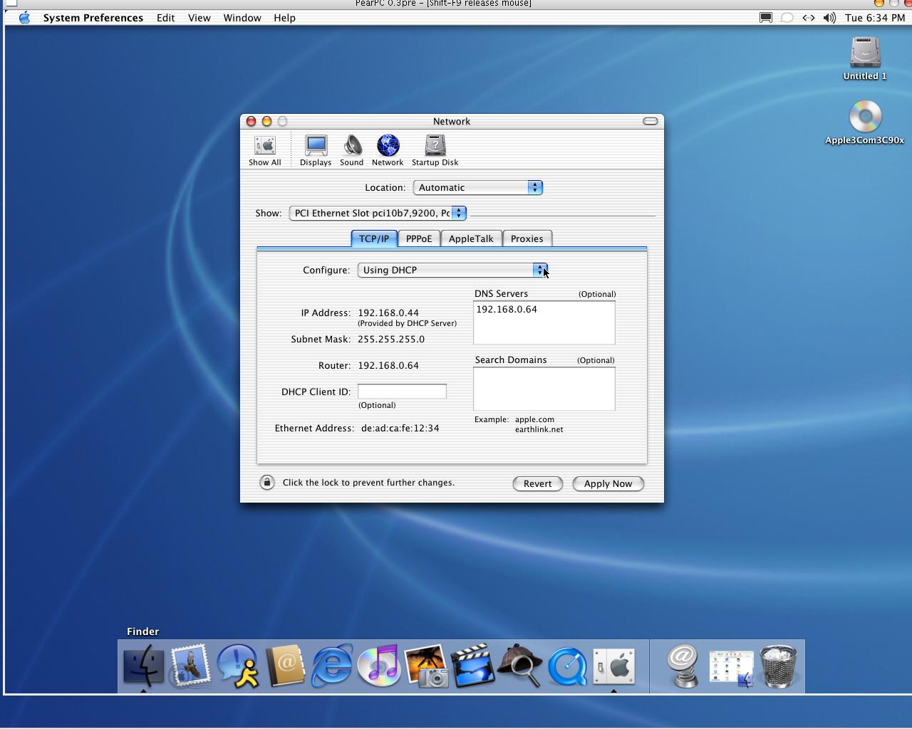

Can someone help me set up my internet?
Look at these i made os x 10.2 recognize the insternet card
but how do i set it up?
I tried these set up but nothing http://dev.realistanew.com/win32net/
Look how my mac network is seted up what do i need to change?
same here with OS 10.3.4, configured as the tutorial states, but no go in safari. I even tried bridging the network instead of ICS, yet it still doesn't work. The OSX DHCP seems to picked up the IP and gateway correctly, cause if I change the gateway in ICS, the OSX DHCP also change, but still I can't load any web pages in safari. Any ideas?
Is your router's IP really 192.168.0.64?

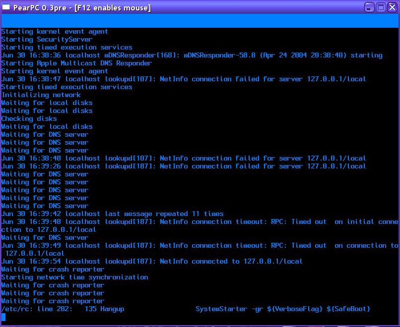

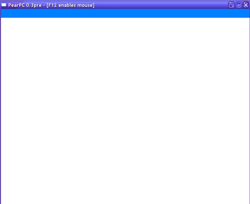

hi guys!
well my problem is since i downloaded the nightly build optimized for P4 with the date of 6.28.04 (cvs build @ http://www.richardgoodwin.com/pearpc/)
1st the ppc only booted when i added a "#" to the line of "key_compose = "F11" otherwise it wont
2nd when it booted i have like half an hour waiting for the boot to the OS and this is where it get stock(1st screenshot)
and then it booted but this is waht i got besides a strange blueish color(2nd screenshot)
any resolution to this, ill be happy to accept it
sayonara!!
sayonara!!
same here, I had to disable key compose also.
As for the blue color, use ppc_start_resolution = "800x600x32", that should take care of it.
also prom_bootmethod = "auto", seems "select" won't work im 0.3.
And lastly, disable the cdrom, someone said it stopped working in 0.3.. ;\
another bug is F12 is whacked now, cusor gets stuck in OSX. Use Ctrl-Alt-Del to get your cursor back to windows.
but good news is clock is fix and supposedly you can run at full screen and higher resolution.
