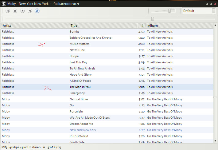

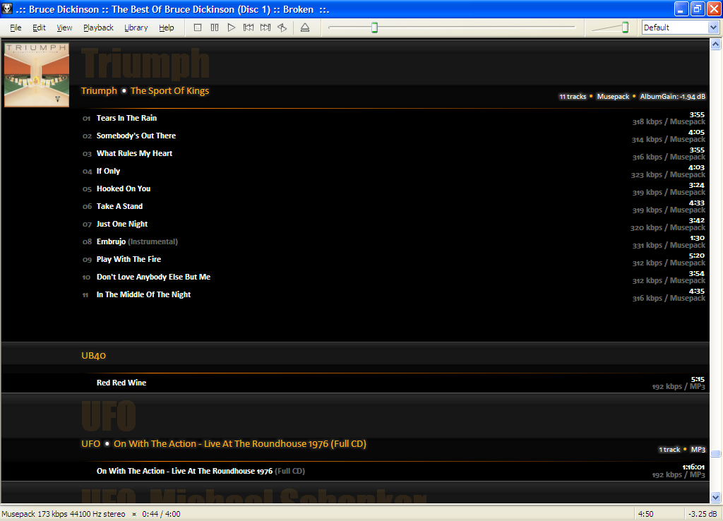

here's mine. I try to keep it as minimal as possible but often I fail miserably. I'm totally in love with the colors of the Tempura VS so I tried to match my Foobar pretty close.
Parts of the scheme are Spex & the tab switching is inspired by smarterchild.
A simple "Now Playing" screen
Single Column Playlist
Album List (pretty sparse as this is my work machine)
Lyrics Panel (I'm still playing with this)
And here is one of the SCP with the Playlist dropdown & tab switch buttons on the bottom (they pop up on mouse over on every tab panel)
All comments welcome.
Awesome, except for the SCP, which I don't like much. Release I say!

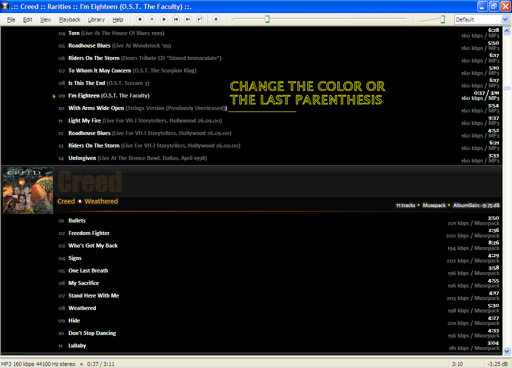

i know this a little bit off topic but can anyone help me here
see image,
i need to change the color of the last parenthesis, cause the code i'm using seems to be confused by the nested parenthesis. is it possible to fix this by modifying the code? here's what i'm using now:
$replace(%title%,'(',$font(calibri,9,bold,100-100-100)'(',')',')'$font(calibri,9,boldshadow glowalpha-50,255-255-255),'[',$font(calibri,9,bold,100-100-100)'[',']',']'$font(calibri,9,boldshadow glowalpha-50,255-255-255))
Thank You
NOTE: the image should read "change the color OF the last parenthesis"
Edited by MyMaster
see image,
Thank You
Try this:
$replace(%title%,'(',$font(calibri,9,bold,100-100-100)'(',')',$font(calibri,9,bold,100-100-100)')'$font(calibri,9,boldshadow glowalpha-50,255-255-255),'[',$font(calibri,9,bold,100-100-100)'[',']',$font(calibri,9,bold,100-100-100)']'$font(calibri,9,boldshadow glowalpha-50,255-255-255))
I think it should work..
Try this:
thanks, that did it :yes:

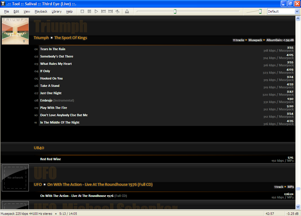

here's my Group display code and pictures of what i get if i go to settings and apply which is what i want, and what i get if i "restart" foobar
$if(%album%,
$imageabs(,,images\album.png,),
$imageabs(,,images\album2.png,)
$if(%album%,
$imageabs2(100,94,0,0,,,4,6,'images\nocover.jpg',NOKEEPASPECT)
$imageabs2(100,94,0,0,,,4,6,$replace(%path%,%filename_ext%,)album.jpg,NOKEEPASPECT)

i do it like this,
// album art
$imageabs(20,0,images\vinyl.png,)
$imageabs(0,0,images\cover_bg.png,)
$imageabs2(48,48,0,0,48,48,6,6,$replace(%path%,%filename_ext%,folder.jpg),)
this is how it turns out:
if you want to add an overlay, you would do it like this
// album art
$imageabs(0,0,images\cover_overlay.png,)
the overlay would have to be transparent ofcourse
these are my images, the vinyl image and line of code is totally optional, i just made it to look that little bit more awesome ;)
just whack these in your "images" folder.
http://i42.photobucket.com/albums/e302/mog...ar/cover_bg.png
http://i42.photobucket.com/albums/e302/moglenstar/vinyl.png
*You will need to replace the image dir global variable in the track info panels according to your foobar directory
