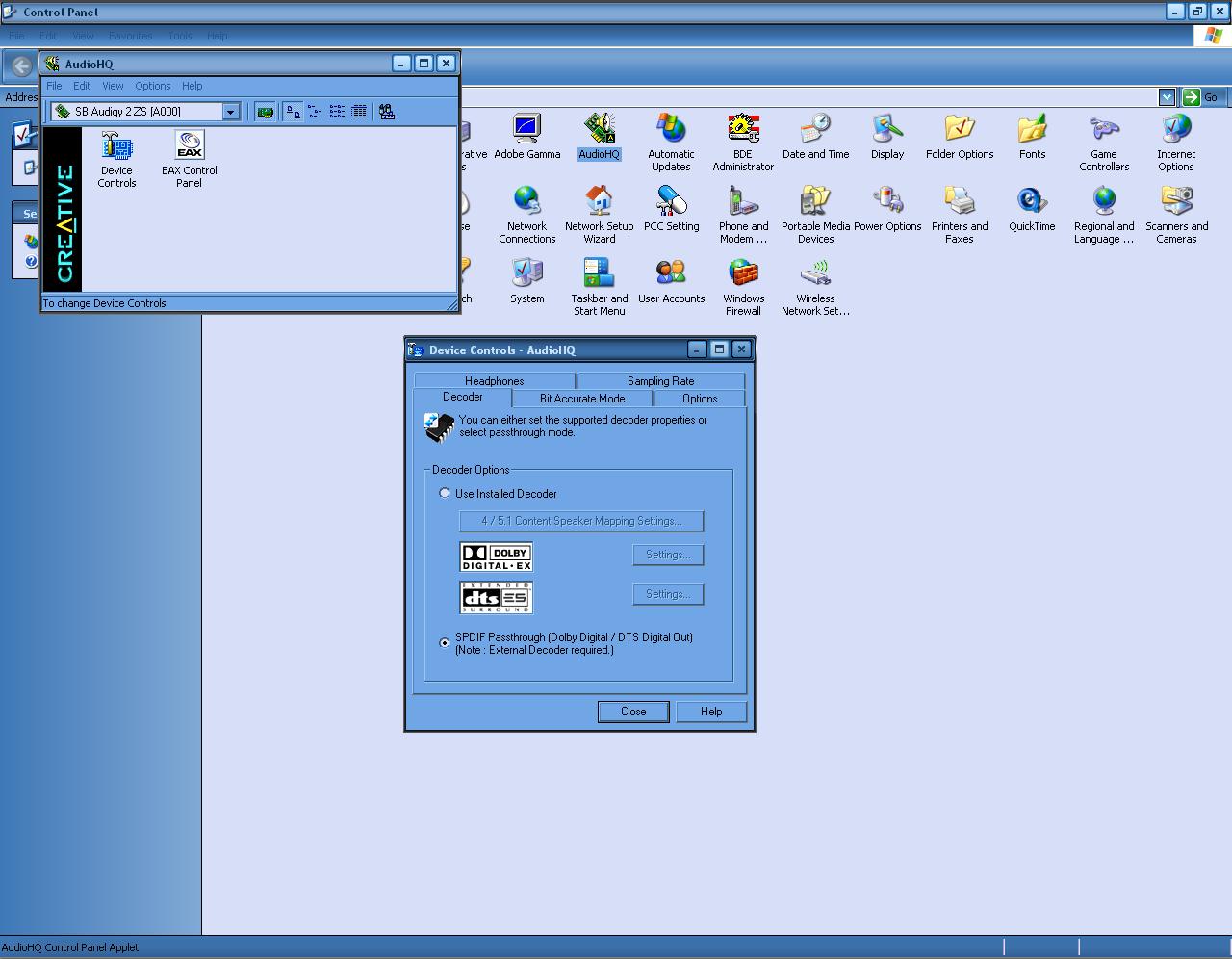

ok i will give it one last try.any ideas on disabling that onboard decoder thing?
