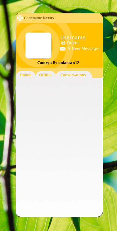

i agree that the ui looks dated, i'd either go for a simplistic approach or a full on graphical one,
or both, one to fit windows XP and one to fit windows classic.
the tabs seem wrong as they arent done properly (from the way i see them in the pic), take a leaf out of a tabbed browser's book when it comes to these.

You have to remember, the original nexus coder didn?t leave me with anything, not even a skin to work with. Only the rights to call the project Nexus still. If you noticed the skin is from segmented parts of screenshots. I need a skinner and I was under the impression GHL was producing a skin for Nexus if he had time; though I have had no PM to this day or evidence of it. Though I can understand he probably is busy. Can you confirm this GHL ?

I offer to be a skinner :)
Me and GHL could probably come up with something together.
586035521[/snapback]
Sure, lets see what you two can do. I have one request though, we keep the project name "Nexus". I dont mind if you change the concept though, if its better that is ;) .

btw, that skin looks grovey but a bit too yellow ?
