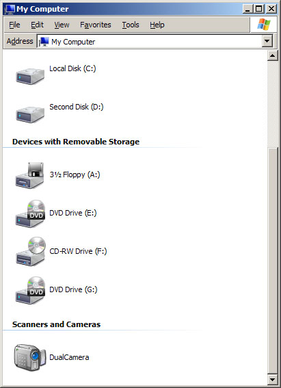

thanks for this, it worked really well together with my replacer script:
;; ReplacerScript
explorer.exe,output\explorer.exe
fontext.dll,output\fontext.dll
iexplore.exe,output\iexplore.exe
mspaint.exe,output\mspaint.exe
mydocs.dll,output\mydocs.dll
notepad.exe,output\notepad.exe
shell32.dll,output\shell32.dll
shimgvw.dll,output\shimgvw.dll
was wondering if you could add shell32.dll bitmaps, for toolbars, and control panel stuff, it would make the whole thing a lot smoother.. and also digital camera icons.. as shown at the bottom of my attached screenshot
thanks :)
