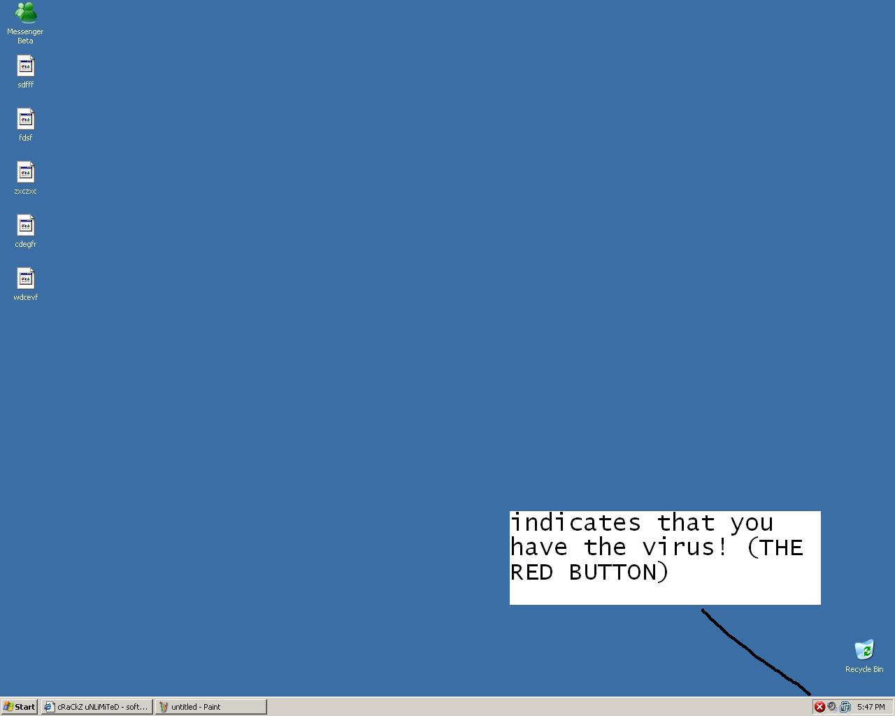

Sawyer12 the video above is from a trusted site, it contains nothing, still if you don't want to watch it I can tell you that if you are infected you ll immediately notice because your desktop background will turn either black or blue and it will have a huge warning saying that you are infected, there will also be a warning and icon on your system tray telling you the same and prompting you to click on it to resolve the problem, however both warnings are fake and part of the virus to trick people into clicking and installing the rest of the trojan, At that point without clicking you will already be infected with a system you cannot change the desktop background to, several changes made to your registry and several .exe files placed in different areas of your system, you will also see that your system enters in a loop where everytime you restart the computer the same program tries to make you click and install the program, if you do then your system will be even more compromised.
This virus also tricks people cause it sends you to a page where supposedly you are going to buy an anti-spyware or anti-virus program, you ll be sending your information to a bogus site which will not give you any software at all. So far this is what I know about the virus, but there's lots more it can do and it appears there's several dangerous variants of it on the wild.
That's what you will see on your system tray too if you are infected.

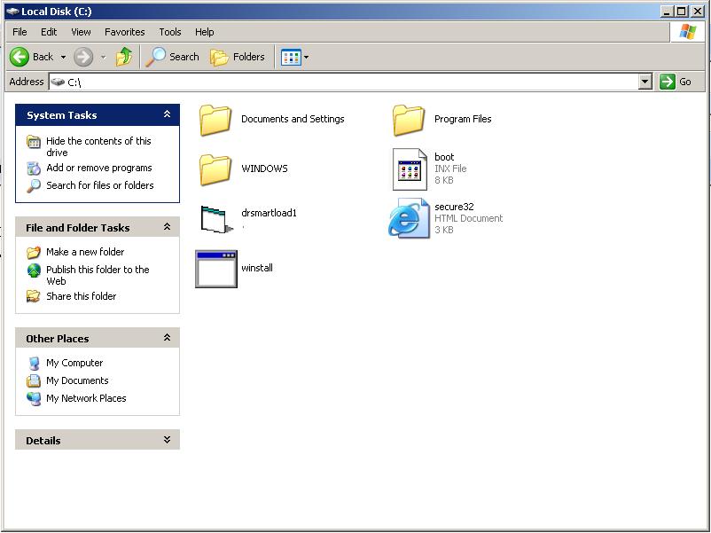

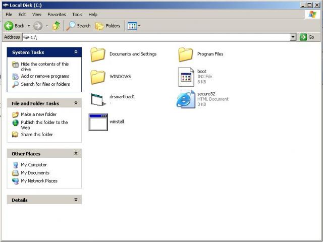

Here's some screenshots i took of the virus in a virtual machine...Whats strange is, I got this virus about 3 months ago! I eventually got rid of it, after hours of deleting crap...but i kept getting plastered with adverts in internet explorer and firefox, even after I had made sure I had gotten rid of this virus. I eventually wiped my computer as it was beyond a joke. There was nothing in Task Manager, yet I would get about 10 adverts every minute...even flash ones that I couldnt close! yet still nothing in Task Manager.
I really hope a patch is released for this soon, as I do not want to get this virus AGAIN!

Well this has been interesting to say the least. While in IE the WMF file did nothing (expected). Whether viewing the file or clicking the link nothing happened. Once saved to my hard drive and opening the file in Image viewer the exploit was able to run. I denied BOOT.INX access to the internet and after a reboot almost all was well. The task manager was disabled but that can be fixed via gpedit.msc or the registry. I also found the following registry keys were created.
[HKEY_LOCAL_MACHINE\SYSTEM\ControlSet001\Services\SharedAccess\Parameters\FirewallPolicy\StandardProfile\AuthorizedApplications\List]
"C:\\boot.inx"="C:\\boot.inx:*:Enabled:enable"
and
[HKEY_LOCAL_MACHINE\SYSTEM\ControlSet002\Services\SharedAccess\Parameters\FirewallPolicy\StandardProfile\AuthorizedApplications\List]
I am not a security professional but these keys look like they allow boot.inx to be accepted by Windows Firewall. So far it looks like a decent firewall and a little knowledge can keep you fairly safe from this. I will try a few more things and post the results.
EDIT: I found something else out. If the file is saved locally DO NOT EVEN HOVER OVER IT!!! Even if its on your desktop without a preview it will allow the exploit to run.
