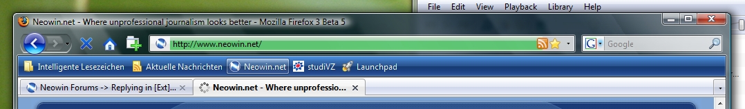

But I notice lately that the "e" in File and the "p" everywhere is cut off (the search box, address bar and bookmark toolbar) Is there a way to fix this?
At the moment I'm not sure since this is an issue with XUL elements having an opacity or rounded borders. I've seen this without using Glasser.
Mozilla Bug 363861, you can signup and vote on the bug here as well.

Is some text being cut off slightly early a bug with running this, or a bug with FF3 Beta 5? (text in FF itself, such as on bookmarks toolbar/search toolbar). Text on forums/webpages is fine.
I haven't noticed it till I installed Glasser :/
edit: It seems Glasser causes the text cut-off. When it's disabled, text is fine.
Minor issue though!

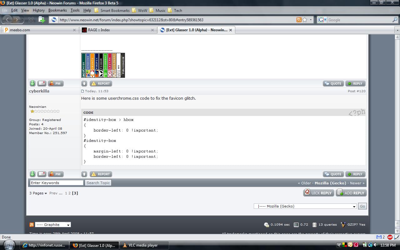

Any chance you can fix the visual glitch on the favicon box to the left of the location bar?
It only happened a few nightlies ago, but it has knocked the left border out by about 2 pixels.
I'd fix it in userchrome, but I don't know the name of the thing I'm trying to change. Besides, it looks like the change is done in your extension anyway.
Any chance of a quick fix? You probably only need to change a little bit of css to compensate for the recent change in the default Firefox Vista theme.
I have a question. How do I get my top bar ( File,edit, etc. ) to be colored like you guys? Is it because of the Visual Style I am using? Or is it something else I haven't installed?
It is they bookmarks bar they are using, not the menu bar. The menu bar is actually hidden.
Right click near the buttons, check "bookmarks toolbar", then move the bookmarks back there and install some extension that hides the menu. Then install one of the userChrome.css provided in the first post of this thread to get it coloured.
