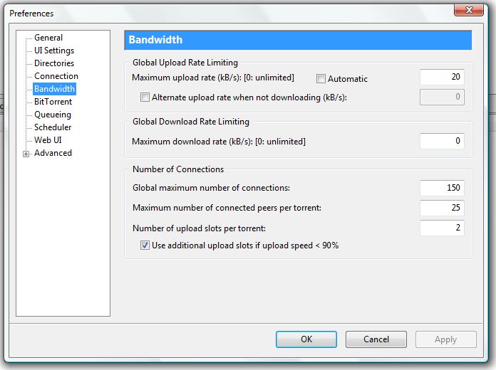

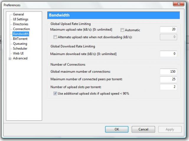

Below is the current settings I have in uTorrent. I lowered the connections by about 25% but the problem still remains.?
Edited by _X_
You have a 20KB/sec upload rate set -- how big is your upload pipe? At max you should be set to 80% of your upload rate.. So your saying you have a 200kbit upload pipe?
Also what are you using for dns? If your trying to access your routers dns forwarder while its busy handling your torrent traffic -- it might be a bit sluggish.. Use an a different dns server, say opendns, or your isps directly or 4.2.2.2, etc.

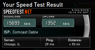

What is the connection speed you get from your ISP? You could go to http://www.speedtest.net/ when your internet is working decent, and your not doing torrents and do a test.
So from this test my upload speed is 1352 kb/s, so lets say its 1200 to be on the safe side. This is reported in bits, so to convert to bytes divide by 8 = 1200/8 = 150KBytes/sec.
Now lets make sure we only use at max 80% of that.. so my upload limit should at MAX be 150 * .80 = 120KBytes/sec if you still having issues lower it some more.

I followed it and changed my dns. So lets see how that works. One final thing, I worked out the upload rate, according to the maths it should be 70 instead of my 20. But isnt that too high? Won't that effect other programmes? Online gaming etc?
Well if your upload pipe is 733kbps, lets call it 700/8 = 87.5 * .8 = yup 70KB/sec would be about 80% of your current upload speed.
So 20 is well below your upload pipe -- and your torrents should not be causing you an issue because of a full upload pipe. It could be that dns is your problem?? Or it could be that router just blows and can not really handle torrents.
