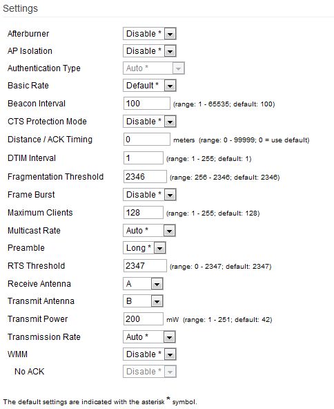

I went into the advanced settings and saw the option "Transmit Power". It was set to 42. I upped it to 90 and then testing the wireless range.
I can now pick up wireless at the door to the garden, which before was impossible :D .
But there is one more query, the range of the power is (range: 1 - 251; default: 42). Would my router die if I upped it beyond 100? Even close to 200?
To make this whole wireless situation perfect I would like to receive the signal in the garden for laptop use in the summer etc.

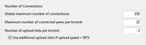

And one final thing. Now I have this router, do I need to up the connections with uTorrent back to its default? Would that see an increase in speeds?

Yeah 25 connections per torrent are going to lower your speeds.. Just make sure to set your upload limit to no more than max 80% of your upload bandwidth and you should be fine. But sure increase the number of connections per torrent and max. The number of slots upload per torrent really depends on what your upload speed is.
Sure you could try increasing the output power a bit, if you take it too high you risk shortening the life of the router. As to how much I am not sure -- do some research on it. If your looking to increase your range -- you could also look to get some better antenna for it.

Its going great so far. However the signal strength issue, although not the end of the world, is still bugging me. I bumped it up to about 200 and the signal is better but not good enough. I guess I shall leave it. I don't want the box burning out because I want the internet in the garden :D

if you bump it up too high you can start to have issues as well.. I would suggest you just get some better antennas for it.. or atleast 1 you don't have to use 2. Just turn off diversity.
As I stated you bump up the power too much and your going to have issues.

Again I will state -- there are no setting in there that are going to increase your range, other than the power! If you want more get a better antennas!
edit: does tomato default to setting one antenna to transmit and the other receive? That should really be on AUTO for both.
