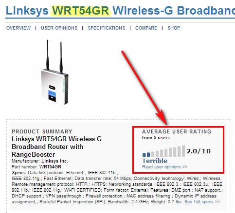

WTF did you buy that router for??? WRT54GL is the one everyone in the thread has been telling you to get.
No tomato does not support that router, nor does dd-wrt, you can get openwrt to run on it -- if you compile it from source.
http://forum.openwrt.org/viewtopic.php?id=16563
I would suggest you return it -- and buy the GL!!
So your router choice came down to the "one they had" :rolleyes:
I would suggest you return it and order the GL model.
http://www.amazon.co.uk/Linksys-WRT54GL-UK...4886&sr=8-1
As to whats wrong with it -- did you not even bother looking for reviews on said product before you laid down your hard earned cash??

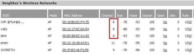

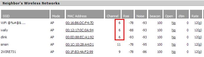

I would highly suggest you check the channel other wireless networks are on, and put your as far away as possible.. Quite a few routers default to channel 6 -- atleast here in the states.. You could grab netstumbler to show you, or once you put dd-wrt on your router you can use the site survey feature to view other wireless networks.
As you can see the majority of other wireless networks in the area are on 6, and the other 2 are higher. Mine is set to channel 1, you want to be as far away in channels as possible to other wireless networks around you. When it comes to connectivity issues also make sure your broadcasting your UNIQUE ssid, hiding it will only make connection to your own network harder and the security suggesting about turning it off is pure FUD!
If your not unique and you have other wireless networks around with the same ssid, then yes its possible for your client to get confused and try to change to a stronger signal, etc.
